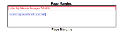

My super high-quality graphic here will help explain why <div> is the tag for the job.
If you "center" align a <span>, technically it will work, but you are only centering your text onto itself (so, not really any use).
Whereas, if you center your text in a <div> tag, you are doing so relative to the page.
The text-align style accepts: left, right, center, justify.
S123 "modern HTML formatting" is, at its core, just HTML formatting. w3schools has a lot of helpful documents. Just keep in mind that S123 doesn't accept all HTML formatting.
