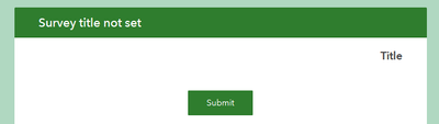

I'm curious what your set-up is, as text-align should work on its own.
Here is what I have in Connect:
And here is the result on the web:
Adding a link <a> or any other content within the div tag should not change this functionality.
It is also oddly resistant to malformed tags as can be seen with two broken end tags:
Still resulting in right-aligned text:abureaux_3-1706125997717.png
Are you using Connect, and is it up to date? Which browser are you using, and is it up to date?
