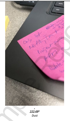

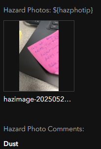

I generally do it as
TypeName
begin repeatPhotos
textPhoto_comments
end repeatendPhotos
The repeat adds a bit more complexity to the process, but you end up with a nice table containing the caption for each photo, and that's what has the attachment table connected to it.
It looks like this in S123 website, and you can make that field get printed in your report.
