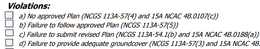

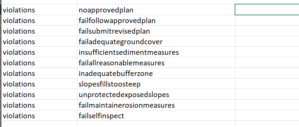

I have created a "select_multiple" question for violations in my inspection form.  My initial plan was to just list all of the violations and the reference to the violation standard just like it shows on the Word document form but I think I'd like to have a note under each violation that shows the standard/rule (the NC numbers) reference in order to keep the form a bit cleaner on a mobile device such as a cell phone.  Any advice you can offer would be awesome!
Paper form violation examples:

Choices tab (haven't finished the labels, yet):

Gah, I wanted to respond with a helpful tip but I did some testing myself and kept running into limitations with the software. Here were some of my ideas:
  • Use the Guidance Hint column to allow users to click an icon for additional information
    • The pop-up hint box will only display a limited amount of characters and doesn't support newlines (as far as I could tell) so it wouldn't work for your use case
    • you could potentially include an image in this field but if it's a large image it may be cut off since resizing the pop-up isn't supported
  • I tried HTML formatting with the <sub> tag so that maybe the code names could be subscript after the main text, but that tag isn't supported
Sorry I couldn't be more help....if you brainstorm some more I'd be interested to hear what you decide to do!
