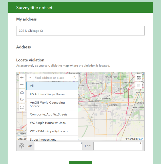

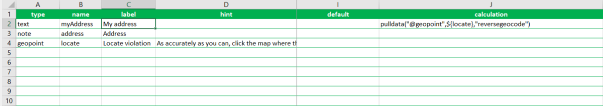

I'm working with an ArcGIS Survey 123 online form, and I can't seem to find direct reference to it and reverse geocoding. When I try pulldata("@geopoint",${location},"reversegeocode") in the calculation field all it does in the map is drop the list of geocoders down from the search bar.
My goal is for the end-user to fill out an address in the text field and have the point appear on the map. It's to save a bit of frustration.

For end user to enter an address in a text filed and populate the point from the entered address on the map, we now have a beta feature to achieve this. This new feature is only available on survey123 beta web application with a geocode appearance.
Please check out the "Geocode appearance in the Survey123 web app" article from our EAC website and use the beta web form to test this feature.
You will see the entered address is matched to an address candidate and pull the lat and long value. You can then use the lat and long value to populate the geopoint using the calculation field concat(number(${latitude}),' ', number(${longitude})) and pass the calculation for a geopoint field.

It's works now:
type                         name                    appearance                   calculation
text                         ADRESSE               geocode
geopoint                LOCATION                                                concat(number(pulldata("@json",${ADRESSE},"location.y"))," ",number(pulldata("@json",${ADRESSE},"location.x")))
