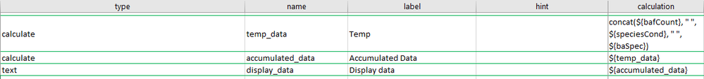

I then tried to create a hidden row to accumulate data, then another calculate row to display, and another row to see if text display would change anything. This generates an error 'dependency cycles amongst the xpath expression in relevant/calculate\n\nResult: Invalid' or it cycles forever and never updates the form.

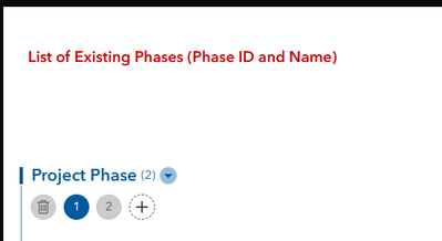

@ChristopherCounsell I am trying to repeat this workflow and cannot get it to work. I did have a join working when I originally completed my form, but it has been broken for at least 6 months. I am not sure if there was an update that caused it to break or what.
I have confirmed that my concatenate calculation works, and believe it is something in step 2 above, as when I unhide the Phase_summary field (see snapshot) nothing appears - it is just an editable box.
Do you have any suggestions of where I am going wrong? Thanks in advance.
ChristopherCounsell
MVP Frequent Contributor
I would recommend making a new post and providing your XLSForm. Unanswered posts get more attention. Feel free to tag me or other MVPs.
Your circumstances sound different. Notably the formatting and you're using the web app. Can't provide any insight without the xlsform to be honest.
