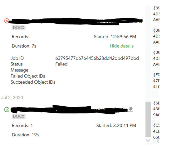

We're having trouble getting feature reports generated from the Survey123 website through our portal. Things have been running smoothly until a few days ago.
I simply get the error:  An error occurred while generating reports.

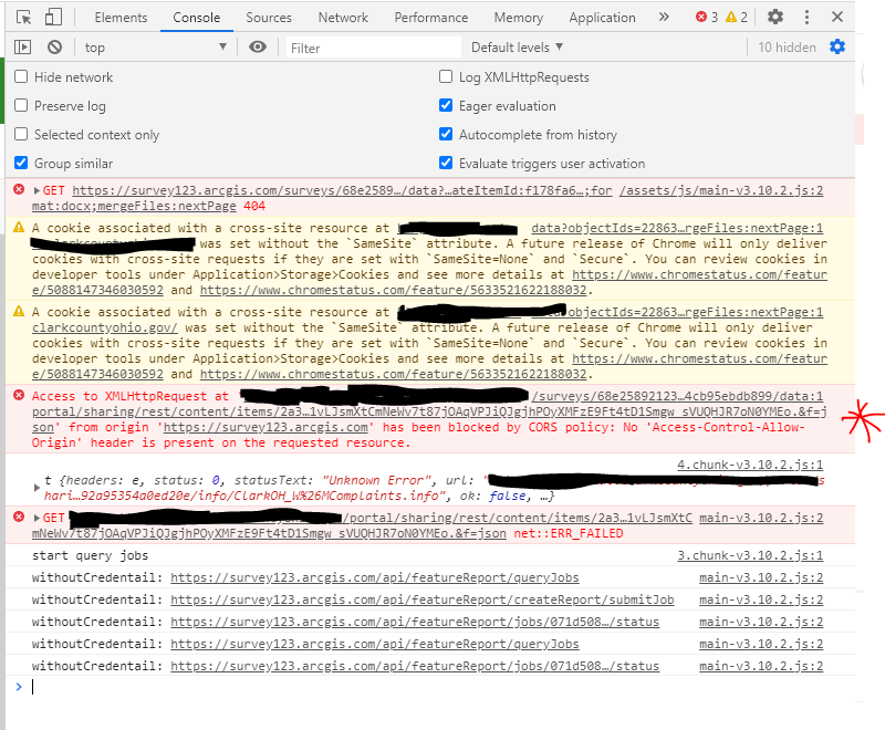

The console shows that there seems to be some issue getting the survey123 resource because of the CORS policy "No 'Access-Control-Allow-Origin' header is present on the requested resource."
No changes that we know of have been made on our end regarding the Portal's security settings...

I have checked the restrict cross domain settings on Portal and I've added https://survey123.arcgis.com/ domain in the Allowed Origins - still getting the same error.
We've checked the web.config file in the web server and portal and this <add name="Access-Control-Allow-Origin" value="*" /> has not been set in any header.
