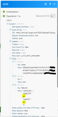

Hi @YuliaMamonova I thought you answer would have solved my issue but not.
here is my http module. everything looks fine but after I send the survey the field is still empty. do you see any error?
thanks!
YuliaMamonova
Hi, I think there might be a problem with your URL, which should look like this:
https://services9.arcgis.com/##########/arcgis/rest/services/service_##################/FeatureServer/0/updateFeatures
Here is the post from Ismael, which explains how to construct a URL:
