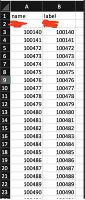

My choice list looks like this:
Up to 60,000.
It works just fine with select_one_from_file choice question.

The only thing in my opinion that can contribute to this error is that my external list is over 60,000 values
