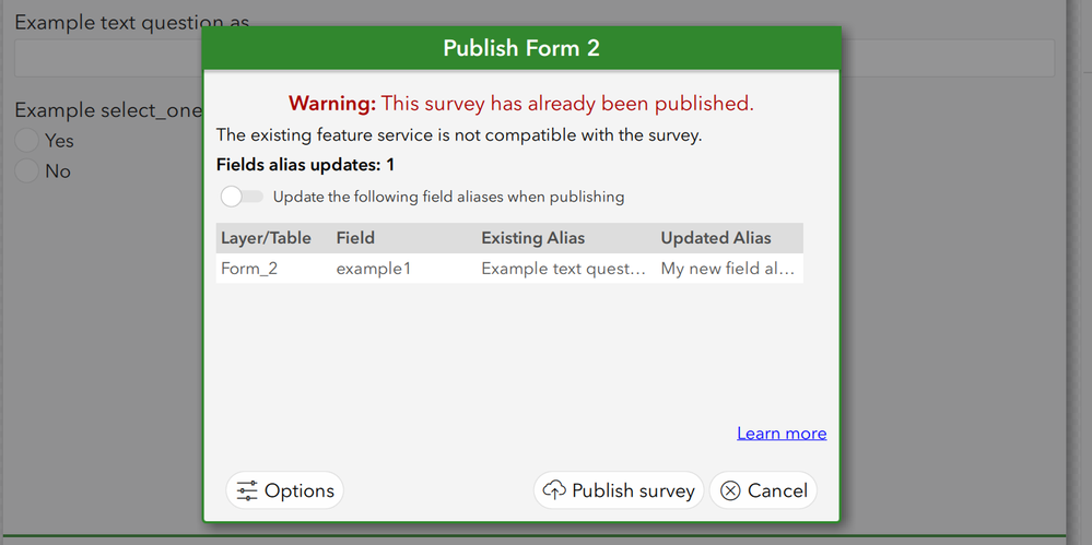

Hi. I want to ask for clarification on this idea. Are you referring to question labels or field aliases?
For context:
  • Question labels are changed when you republish. If you change the label of a question in XLSForm and you republish, the label will be changed in your form accordingly.  The original text in this idea indicates that this functionality is not working. This is confusing, since it works.
  • Field aliases are not updated. That is, if you change the bind::esri:fieldAlias column value, Connect will not reflect the change when you republish. This is a known BUG documented here.
Am I correct assuming that you really meant field aliases, as opposed to question labels? Or am I misunderstanding? If you meant field aliases, this will be addressed in 3.16 and you can test the fix downloading the Beta version from the Survey123 Early Adopter Site.  Including a screenshot of what you will see if your bind::esri:fieldAlias values do not match.  At that point, if you choose to update the aliases, Connect will change them.
By the way @MichelleWilliamsERM  3.16 will take care of domain sync from Connect as well.  That is, you change a list in XLSForm, you publish, and your layer domains will be updated accordingly.  No need to go under the hood adding fields, field aliases or domains...

And I see where the confusion is coming from with label/alias. We see the label here, and we see alias is in your screenshot.
