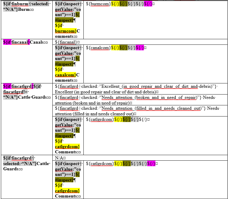

I'm working on a complex report that is, at time of writing, 12 pages long for the template. It's frequently closer to 3 pages in practice, but due to the complexity of the data, the template ended up being quite long.
Sample of part of the report:

I then spent an hour tracking down the twelve exact problem areas, mostly by removing stuff until I found the issue (meaning: remove part of the table, save, upload, check if that fixed the problem, repeat).
It turned out to be a syntax error because the report templates do NOT like if you don't have a space between if and a parenthesis.
The thing is, in that screenshot alone, I have 17 instances of a "${/}" going on. That's about half a page, so doing dirty math, I have 2x12x17= 408 of these things to look for. To be fair, the actual number is 257 currently.
 That still means that I needed to search for the 5% that were causing issues by hand.
