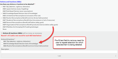

Problem: In Survey123, we have use cases where using a select_multiple question, the user checks all relevant categories that we need to detail in the repeat, but currently there's no way to dynamically create a record for each selected value in the repeat - only the total count of selected values.
Idea: Include functionality in Survey123 Connect so that a repeat can have records pre-created AND pre-filled from a select_multiple question outside the repeat. For example:
Use Case: Enforce rigid data practices so that all required records are captured with no reliance on the user ensuring that they manually add enough repeat records or selected the correct types for each category that needs detailing.

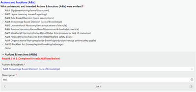

@LindsayRaabe_FPCWA Maybe I am missing something.  Can't you use selected-at(${multi-select question}, pos(..)-1) to get that repeat question to prefill appropriately?
LindsayRaabe_FPCWA
Thanks for the tip - got it to work using the below:
typenamelabelappearancerequiredreadonlycalculationrelevantchoice_filterrepeat_count
select_multiple a_iRelevant_AIs<b>What unintended and intended Actions & Inactions (A&Is) were evident?</b> yes
calculatetotal_aistotal_ais   count-selected(${Relevant_AIs})
begin repeatActions_Inactions_AIsActions & Inactions (A&Is)</b>minimal   count-selected(${Relevant_AIs}) > 0 and not(selected(${Relevant_AIs}, 'None')) ${total_ais}
calculaterec_ais_numrec_ais_num   position(..)
noterec_ais_note_people<b><font color='red'>Record ${rec_ais_num} of ${total_ais} (Complete for each A&I listed below)
select_one a_iAandIActions & Inactionsminimalyesyesselected-at(${Relevant_AIs}, ${rec_ais_num} - 1)selected(${Relevant_AIs}, name)
