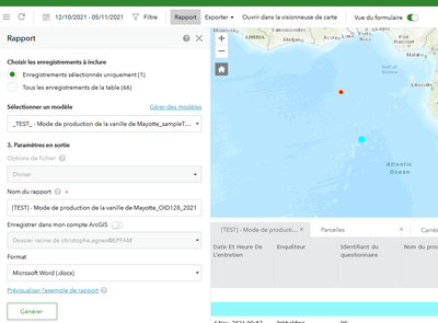

I meant that you could try to use the 'Report' functionality
(in the Data section of your Survey123 web siteChristopheAgnes_0-1636107118792.png) on a blank record.
I tried to bypass the questions flagged as required by editing the feature service directly through the MapViewer. It seems to work fine that way and I can see a completely blank record in my data table.
I guess that the .docx output would need a little clean up but that would be less tedious than having to rewrite all of your questions. Hope that those precisions could be of any help !
