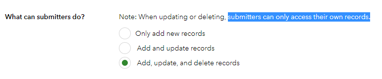

I work collaboratively with a small team. We all contribute to a feature class created using Survey123. Each member might need to add a record, or update someone else's record.
Currently, Survey123 does not allow users to edit other people's records on the Survey123 website:

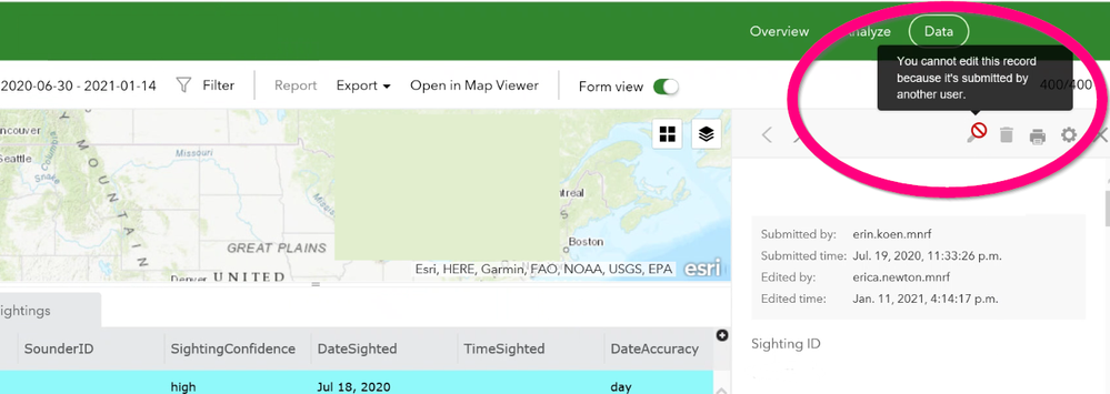

However, we've been able to work around this for most fields by having them update the records in ArcGIS Online. This isn't ideal, as the layout there isn't quite as nice as it is in Survey123 (e.g., they can't see hints). They are unable to update records they didn't create in Survey123 (see screenshot).
The biggest issue we are having is that team members cannot add Images to the the Images field in ArcGIS Online. They have been trying to - but the images get added as "Attachments", which is a separate location, and the images don't show up in the image gallery when filtering for specific conditions on the Survey123 website.
Why allow users to edit some fields via ArcGIS Online, but not all of them? If I want my users to be able to edit all records, I should be able to choose this as an option - especially for such a small team.
