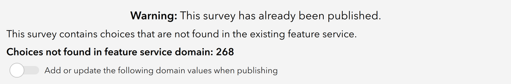

I love that the new version of Survey123 allows you to automatically create domains from your choice lists in the XLSForm.
However, I don't love the current behaviour of the app when I need to change my choice lists. I'm currently creating a survey, so my choices are changing as we make and change decisions over time. There are no data in my survey.
As I republish my survey, Survey123 gives me the option to update my domains:
So I can toggle the button on, but then I get a warning that this will create duplicate domain labels.
We need an option to just re-create domains from the choice list. This doesn't exist.

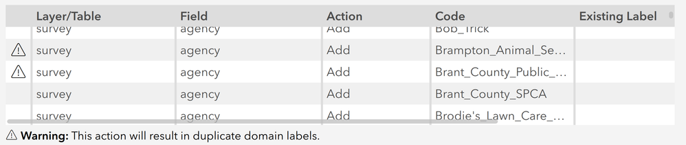

 If we must go manually remove the duplicates, ok... but please consider:
a) expanding the table so I can see more rows,
b) allowing export of the table
c) allowing copying text from the table
d) improving table functionality - every time I try to scroll down, the table "hops back up" to the top, making it almost impossible to even screenshot the records I need to change. 😞
The current table is not user friendly as-is.
