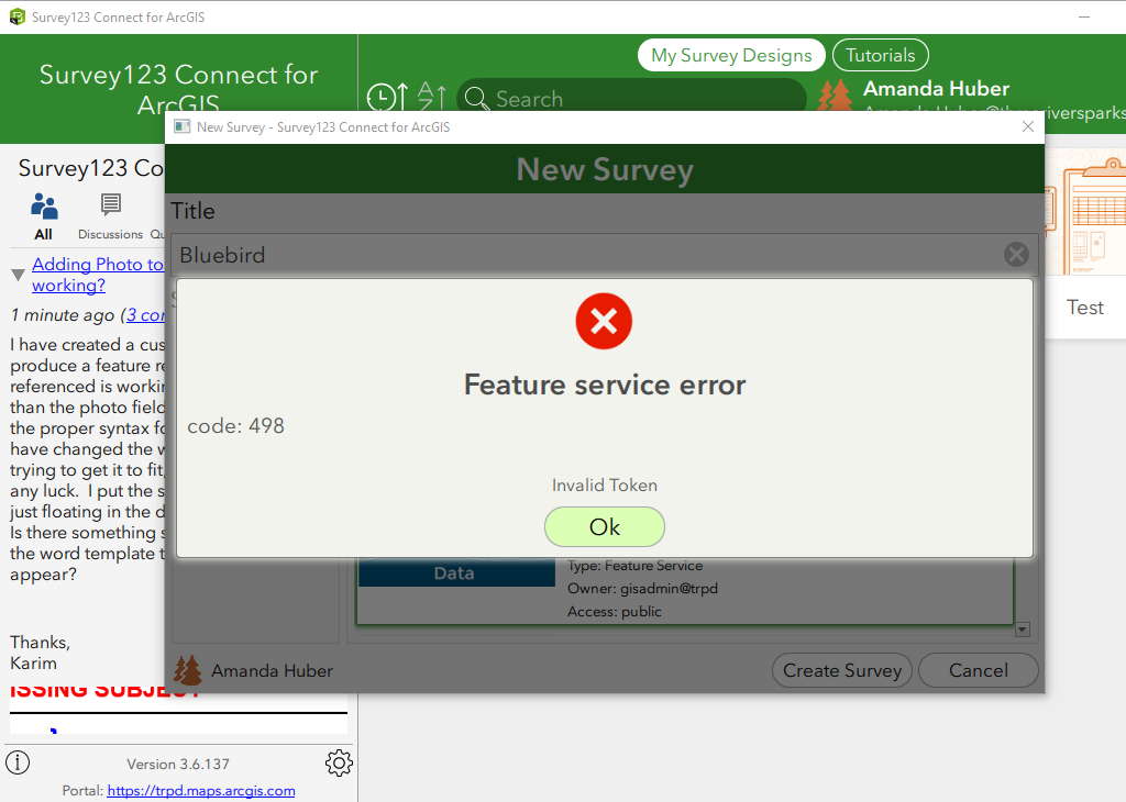

When creating a survey using a feature service hosted in ArcGIS Server, federated with Portal for ArcGIS, and added to ArcGIS Online, an error is returned, "Invalid Token".

When logging into AGOL via S123 and accessing the data that has been collaborated. The data is shown in the list but when we go to create a survey off of it we see the above error message.

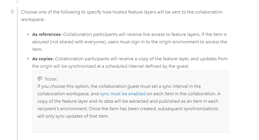

According to documentation for Distributed Collaboration, "Copies" and "Reference" are two separate workflows:
Currently we are utilizing an "As references" workflow with our Publicly Shared Service from a public facing hosting Portal (which is the same as registering the service manually with AGOL).
With that clarified, is a Public facing service distributed by "Reference" supported by Survey123 Connect?
