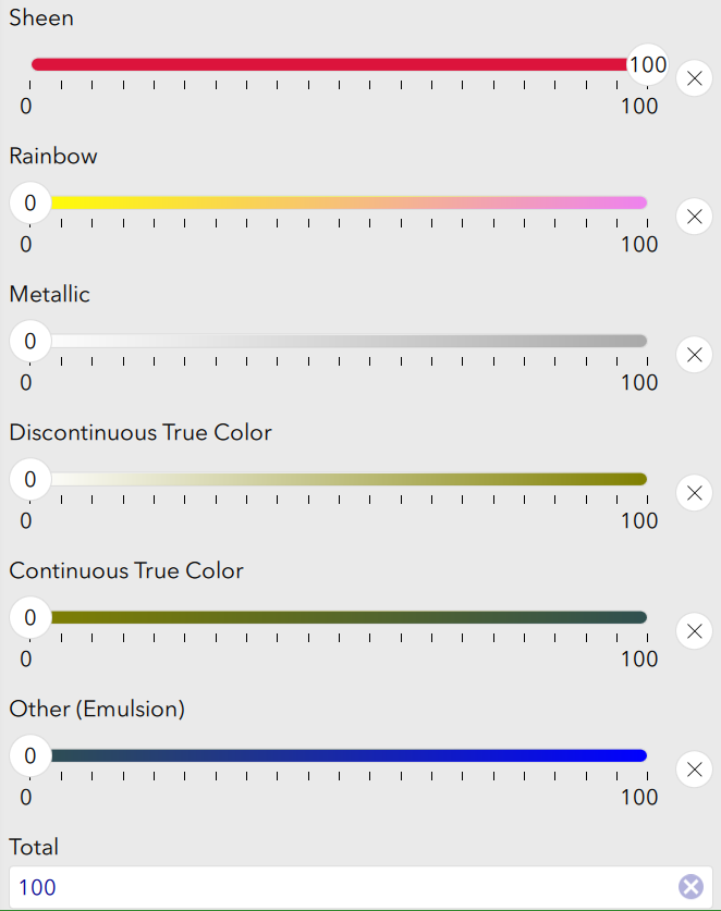

To add another use case.  We want to split an observed area of oil into different categories summing up to 100%.  As you see the below with Sheen occupying 100% all the other values must equal 0.  If Sheen was 50% then that would leave 50% to split over the other categories.
We've also used constraints to restrict incorrect answers but using dynamic variables will improve the users experience.

Hi @LiamHarrington-Missin,
how did you get the ranges without the reset button? Is this possible for the web-app? I am using Connect.
