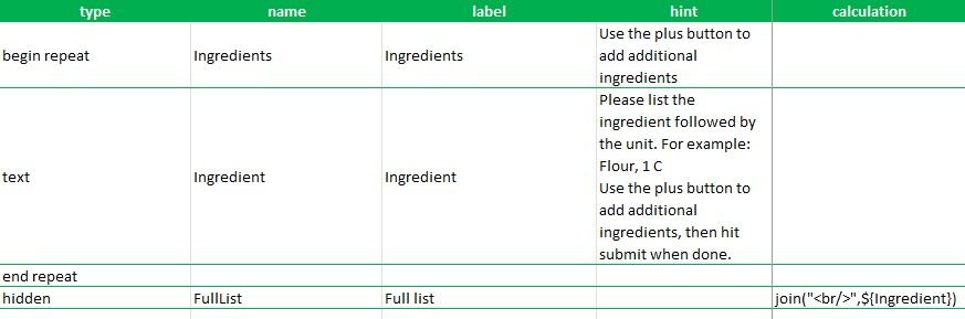

AKitch
I think this can be solved by using repeats. They don't list like you're wanting but they can be configured so duplicate ingredients couldn't be entered (unless spelling is different).
https://community.esri.com/t5/arcgis-survey123-blog/survey123-tricks-of-the-trade-repeats/ba-p/89804...

Here's the survey settings I used based on that article. For the hidden field calculation, I played around a bit and found that a <br/> tag worked both in pop-ups and experience builder for putting each entry on a new line!
XLSForm settings

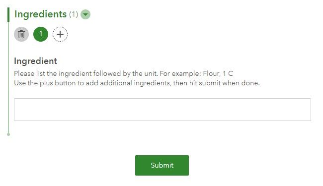

Form entry
It's fine, but it'd be nice to be able to customize the plus button and/or change how the user interacts with it. I feel like intuitively I'd want to hit submit to submit an ingredient and then keep going to add another.

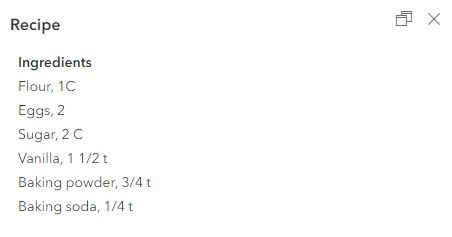

Pop-up (with a text content block)
Looks great, no Arcade or extra formatting needed! The <br/> tag even works when using the default field list option.
