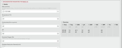

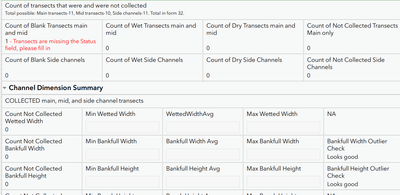

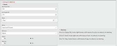

Not sure if it will help you, but I have a work-around that has been helping me. See examples below. Still both WIP, but I am liking what I see so far. Basic concept: Use calculates with concat() and notes to display the data in a table-like format. Ensure you set all the calculates and notes to Null or you may get submission errors if the length exceeds 255.
  1. Create a repeat with your input
  2. Create a group for overview. I have two versions below: One is just a group with notes. The second is a group with a specified width and several smaller internal groups. This second version more closely simulates a table.
  3. Create a main group that contains both previous groups and set its appearance to w2 (Note that I am not using grid-theme. Grid-theme is... bad).
Three limitations I have found: 1) Alignment is centered rather than top (less of an issue as you add more data), 2) group width cant be dynamic (as you can see in the GW monitoring example), and 3) To view side-by-side, you obviously need to have a wide screen (this is more a limitation of the second version below).
