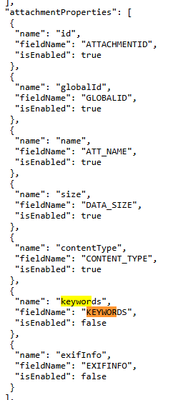

The reason for this is that we have moved towards Branch-Versioning to be able to make surveys from it, as opposed to traditional versioning. What we've found is that the Branch Versioned surveys do not print image questions because the attachments keywords are turned off.
View of the feature service's JSON, showing keywords are disabled.
The end result of this is that the only way to print the attachments is by using the ${#$attachment} syntax, which gives all the attachments at once out of context.
Please give us the ability to print images in the correct context each feature's report by enabling the keywords in branch-versioned services.

Does Upgrade Attachments not add the right columns and fix the issue? I have branch versioned datasets in my 11.1 setup and running that tool gets things working perfectly. That said, if the latest version of EGDBs don't create attachment tables with those 2 attributes under all cases I'd say that's a deficiency, it's a trivial thing that would save everyone a ton of time.
AlfredBaldenweck
Update: Upgrade Attachments being run on the table prior to publishing the service did, in fact, fix this issue.
I've logged an Enhancement:  ENH-000179432: Apply the Upgrade Attachments workflow automatically when publishing a survey to a branch versioned dataset.
Reason being that if this is going to cause a problem, it should just happen automatically to prevent the problem.
This can probably be marked Closed, I guess?
