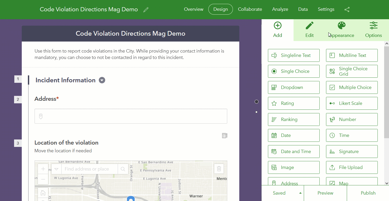

Q. In the report violation demo you created the survey using the web designer. Can I automate tasks on top of surveys authored from Survey123 Connect?
A. Yes. How you create the survey does not make any difference.

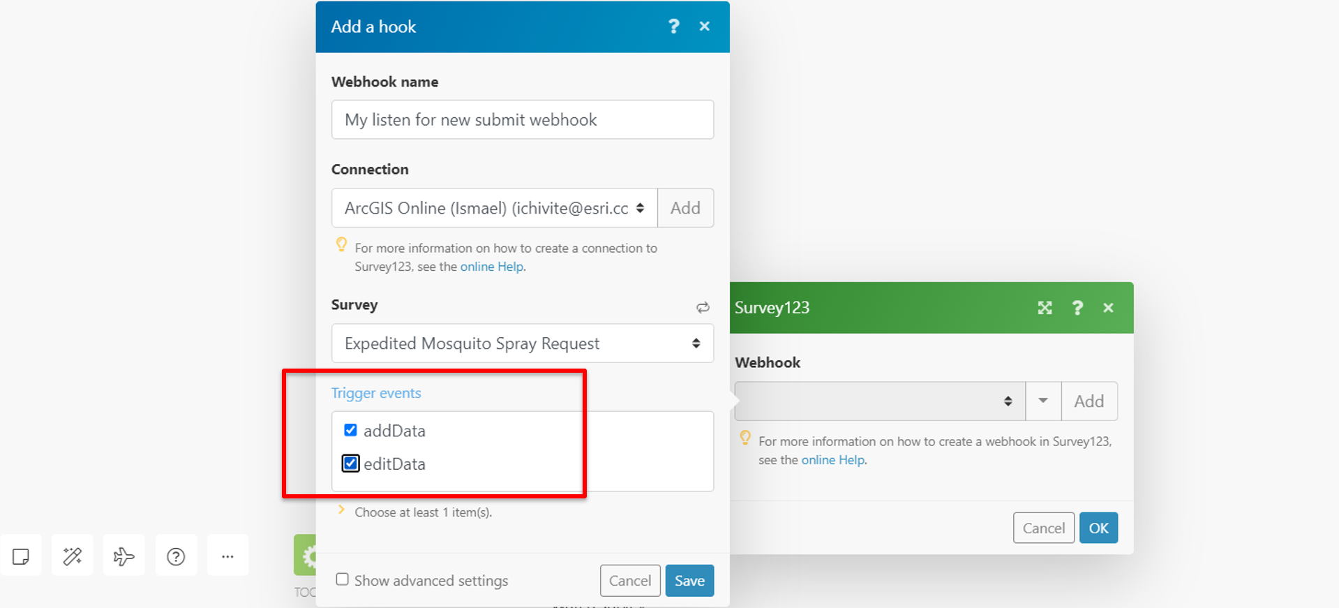

Q. How can I trigger my workflow when Survey123 updates a record in ArcGIS?
A. By default, Survey123 will only trigger your workflow when a new record is created. However, you can also trigger workflows after an update.
If you are using Integromat, you can control the trigger events when you setup the hook. See below.
If you are using Microsoft Power Automate, you can control the trigger from the Survey123 website Webhooks dialog as shown here:
You can make your flows do different things depending on if the trigger is for a record update or a new record. The Survey123 hook payload includes a property called Event type, which takes a value of add or edit. For example, if the Event type is edit, you would then use an action to update a row in your spreadsheet or some other table.

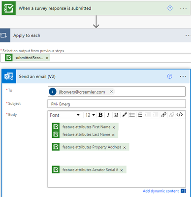

I'm new to power automate, I have created several flows to send email on a submitted survey123 form.  One form I tested, it sends an email with only the header. No other information?  2 other flows do not send any email?
I have used feature attributes selections from the dynamic content drop down in the body of the email, but the information does not show?
example of my flow.....
