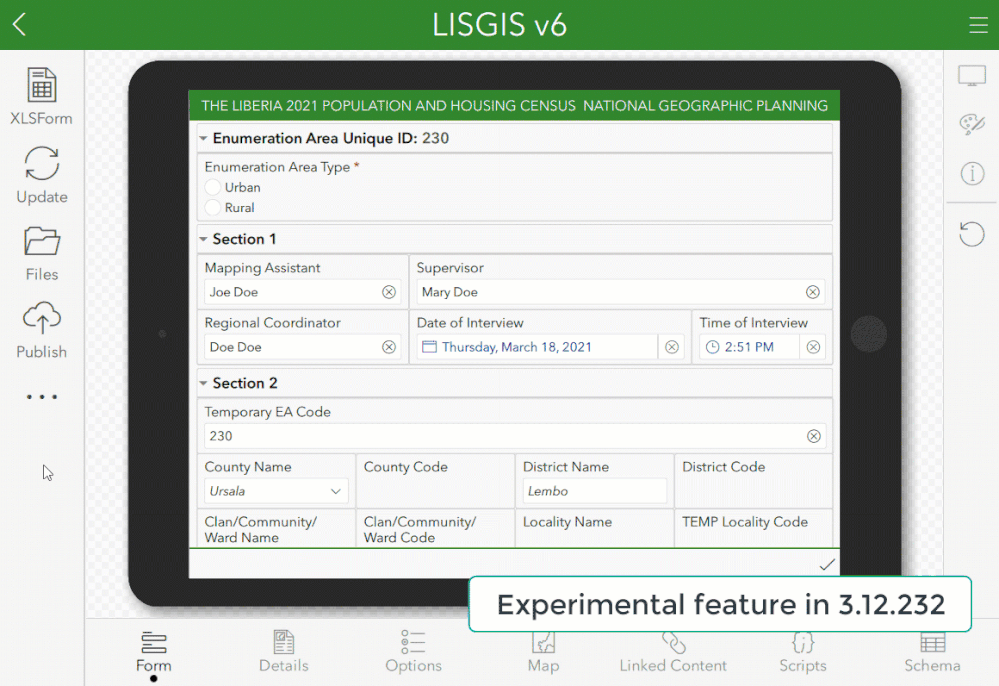

Also, in Survey123 Connect, the 3.12.232 build includes a hidden feature to disable the automatic update of choice list indexes when refreshing the survey preview.  For context, starting with the 3.12 release, choice lists are indexed using SQLite. This brings a performance boost and a reduction of memory usage in the Survey123 field app when using very large lists, which is great; but it also seems to cause an overhead when updating (refreshing) survey designs in Survey123 Connect.  I say "it seems" because we do not know how much of the slowdown can be attributed to the building of the indexes.  The slowdown, in fact, is not general: It only affects some Windows environments, but not all.
With build 3.12.232, you can choose to disable the automatic update of choice list indexes. You do that with a press and hold on the Update button in Survey123 Connect. If the button is red, the indexes will not be rebuilt on every refresh. If the button is black, indexes will be rebuilt every time you refresh your design or save your XLSForm in Microsoft Excel.
As I indicated, we do not fully understand the cause of the slowdown yet. We will continue to investigate, but we hope this little workaround will help in the meantime. We would love to hear if this makes any difference to your surveys in Connect. Leave your comments below or post them in the Early Adopter forum.

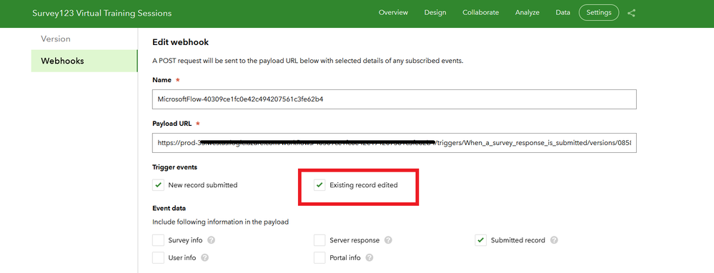

  • Edit mode: You can now easily trigger your Microsoft flows when the survey is used to edit data. All you need to do is to enable the Edit trigger in your webhook using the Survey123 website, as shown in the next screenshot.
You will notice that the webhook payload (Dynamic Content in Microsoft Power Automate jargon) now includes a property called event, which can be either addData or editData. This is useful to create conditions within your flow to do certain things when a new survey is created, and others when it is updated.
  • Portal info: Newly created flows will automatically include the portalInfo object in the payload. This is important because the portalInfo object contains the ArcGIS token of the user triggering the event. The token can be used to retrieve the survey attachments, or to enrich the survey record with additional information generated within the flow.  If for whatever reason you do not get the portalInfo object in your existing flows, you can use the webhook dialog in the Survey123 website, as shown above, to make sure the portalInfo is added to the webhook payload (also known as Event data).
