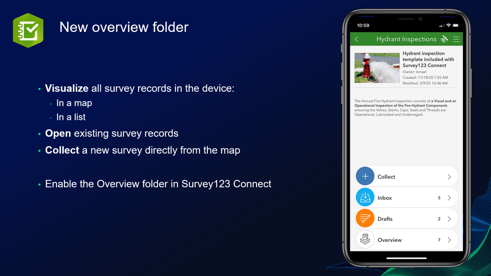

How is the Overview folder different from the Sent folder? The Overview folder is designed to help end users visualize all survey records in the device. That is, records from the Drafts, Outbox, Inbox and Sent folders. Records  are displayed as a list, and in a map.  Additionally, you can also use the Overview to create a new survey at a particular location using a map.
The Sent folder helps end users understand what records they have already sent to ArcGIS. The author of the survey can allow end users to open and edit already sent records.
Does the Overview work offline? Yes.
How do I enable the Overview? In Survey123 Connect, open your survey and go to the Options tab. You will find an option to enable/disable the Overview.

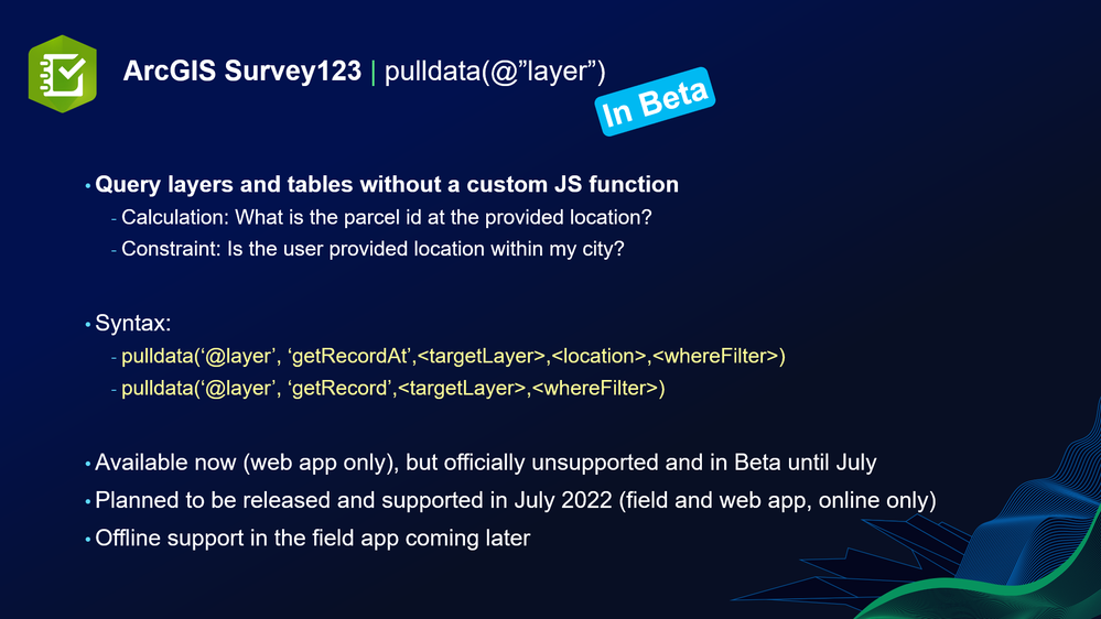

Can I use pulldata("@layer") without an ArcGIS account? Yes, pulldata("@layer") can be used in public surveys. Respondents are not required to login for this function to work.
Why pulldata("@layer") does not work in Connect?  pulldata("@layer") is currently in Beta and not fully implemented. As of today, it only works in the Survey123 web application. You will need to include your pulldata("@layer") expressions in your XLSForm, publish and test in the web app.  Support in Connect and the Field app is planned for July 2022.
