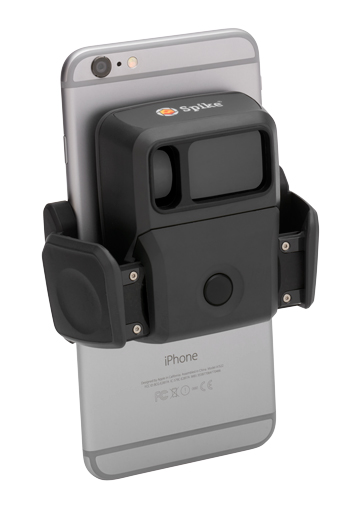

About Spike®
The Spike laser: The most visible aspect of Spike is the laser instrument. It is an eye safe Class-1 laser, designed to measure distances in a range between 2 and 200 meters with an accuracy of 5 centimeters. The laser is designed to be attached to your smartphone or tablet and paired using a Bluetooth connection.
Spike units have a retail price of $499 and are sold online and through a network of resellers.
The Spike app: Once the laser is paired, the Spike app uses the camera on your smartphone or tablet so you can take a photo of your object of interest. Using the distance to the photographed object captured by the laser, the Spike app can accurately calculate lengths and areas as you draw lines and polygons over the photo.

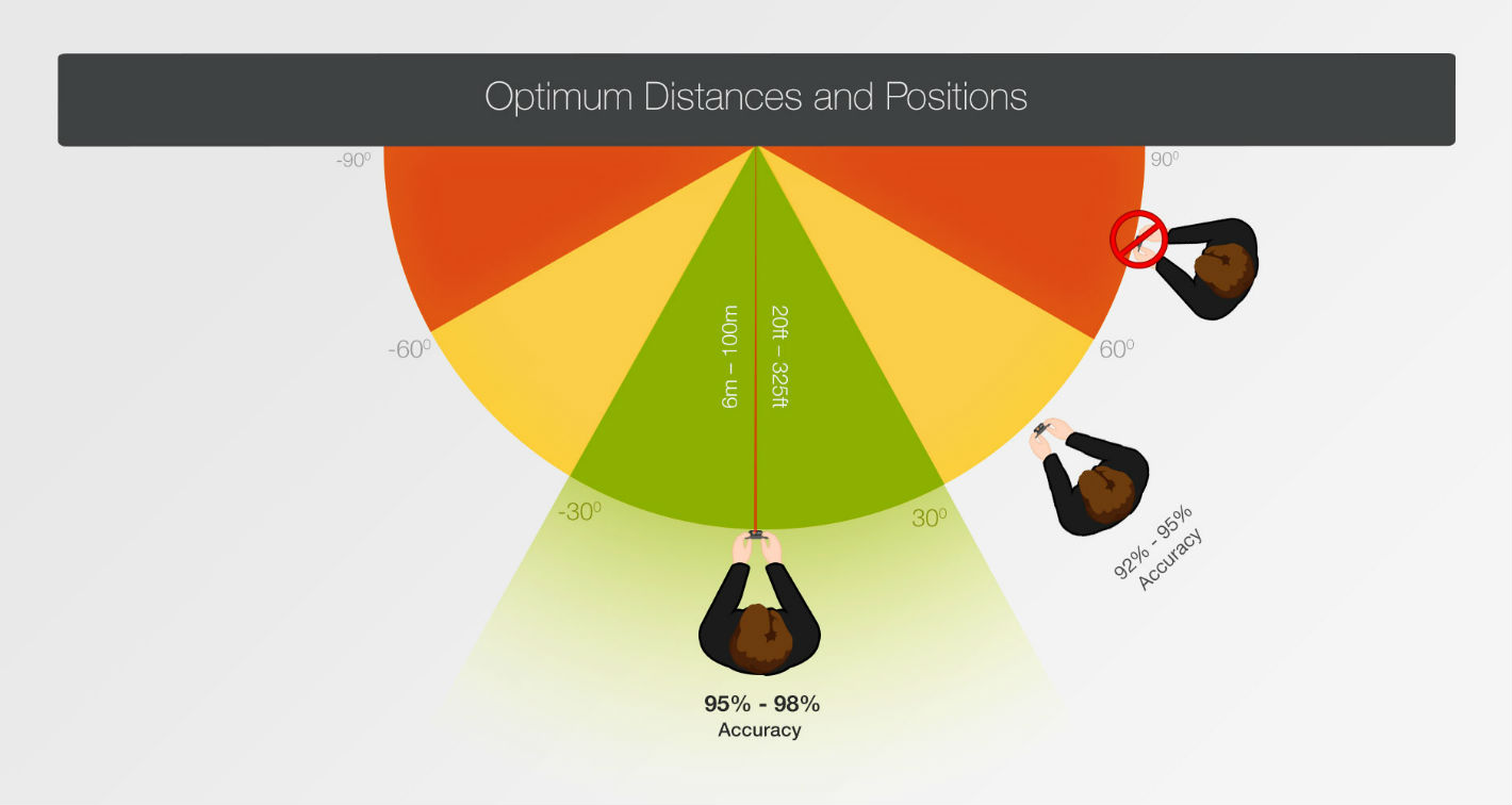

Let’s describe next what used correctly and ideal conditions means:
  • Measurements against a flat surface: You should only perform measurements on flat surfaces, such as a wall or a sign. The specific shape you want to measure should be on a rectangular plane. This is because you will need to define the plane in the photo before you can measure anything.
  • Face your target front-on: For the most accurate measurements, you should take your photo while facing your target perpendicularly. That is, you need to be right in front of the plane on which you will do your measurements. If you need to take your photo at an angle, the expected accuracy of the measurements will be reduced progressively as you get further from being perpendicular.
  • Ideal target range: The ideal working range of the laser is between 6 and 100 meters, although technically you can push the limits and measure objects between 2 and 200 meters away.
  • Center your target: You also want to make sure that the object you want to measure is right in the center of the camera bulls eye, because the laser always calculates distances through the bulls eye.
  • Draw accurately: Once you have taken the photo, you will want to make sure you accurately draw your lines and areas for measurement. The Spike app has a handy magnifying window that will help you with that task.   If your photo is taken following all the tips above, but you do not take pride in carefully drawing the exact shapes you want to measure… the measurement will not be as accurate as it could be.
