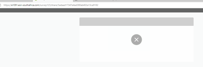

When installing Survey123 Web you cannot open the surveys in the browser, this is because Survey123 is looking for https://www.arcgis.com and https://survey123.arcgis.com/api in the background

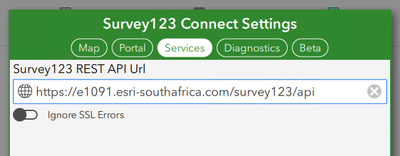

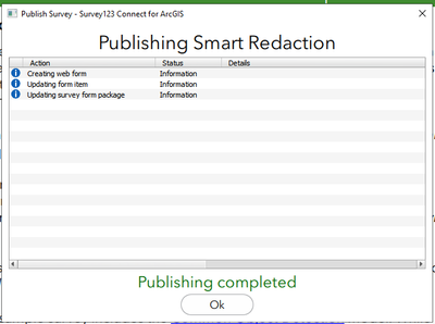

Go to setting then services and change the https://survey123.arcgis.com/api to your Survey123 Web URL and add /api on the end, this will allow you to publish surveys after signing in.

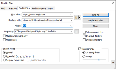

open the application as administrator and press ctrl + f this will open the find dialog, go to find in files, and make the following two replacements.
replace www.arcgis.com  with your portal your portal URL e.g. https://portal.com/webadaptor
at C:\Program Files\ArcGIS\Survey123website

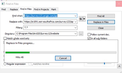

and find and replace https://survey123.arcgis.com/api with your Survey123 Web URL and add api at the end e.g. https://survey123_dns/survey123/api

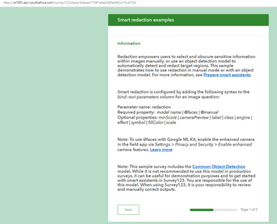

Restart your webserver.
in my chase after making these changes I was able to open up surveys in the browser.
