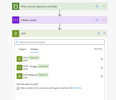

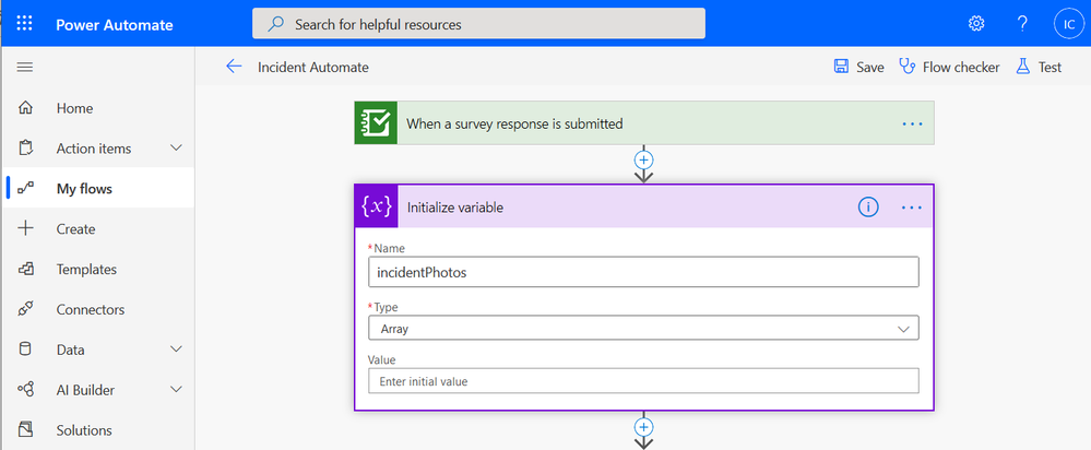

Immediately after your Survey123 trigger, add the Initialize variable action. We will populate this variable later with the attachments from your survey. Make sure you set the action Type to Array and set a descriptive name. Leave the initial value empty.

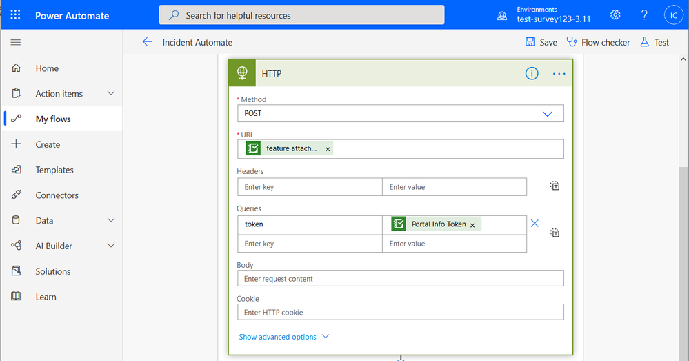

Next, add an HTTP action. This will help us download the attachments. Set the Method to POST. For the URI, you will use the Dynamic content dialog and select the feature attachment URL for your question. In my case, the question with attachments in my survey is called photo, so the dynamic content is feature attachments photo URL.
If you are working with a survey that is shared privately, you will also need to add your token as a query parameter. You can get a valid token from the dynamic content dialog (Portal Info Token).

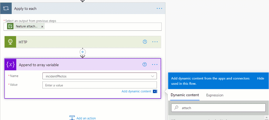

Immediately after your HTTP module, add an Append to array variable action.
  • For the Name, select the variable you initialized at the top of your flow.
  • For the value, you need to carefully enter a JSON string specifying the ContentBytes and unique Name of the attachments.
  • Start by adding this JSON string
  "ContentBytes": <Your HTTP action Body goes here. Build using an Expression>,
  "Name":<Your feature attachments name goes here. Get from Dynamic Content>
  • Now, replace the ContentBytes and Name values as follows:
    • ContentBytes: Use the Expression tab to write the following expression: base64ToBinary (body('HTTP').$content)
    • Name: Use the Dynamic content tab to select the feature attachments name property for the question with your attachments. In my case it was feature attachments photos name.
fow3.gif Make sure you set your JSON value accurately. Do not forget the commas, curly brackets and other things that make JSON be JSON...  Do not forget the comma right after the Body Content!

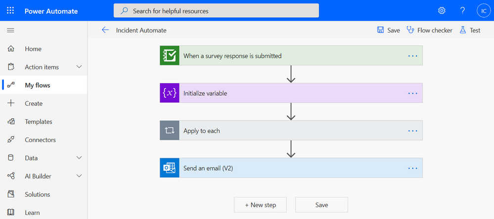

Add a new Step to send an email.
 The key to setting up the Send an email action is to open the Advanced options panel and click the Switch to input entire array icon.
 You will now be able to use the Dynamic content dialog to select the array variable you setup at the beginning of the flow.

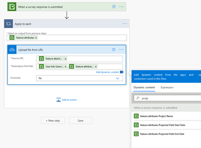

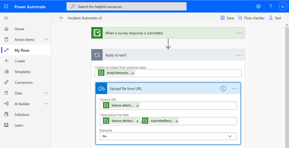

If you want to upload your attachments into Microsoft One Drive, for example, you can use the Upload file from URL action. For the Source URL property, select from the Dynamic content dialog the feature attachments URL array for the appropriate question in your survey. Remember that if working against a private survey you will also need to add your token to the url (?token=[Portal Info Token]). An apply to each block will be added automatically for you. Now all you need to do is to select the Destination File Path for your file. You can select an existing folder, or even create a new one.
In the example above, I set the Destination File Path using one of the questions in my survey. The value of my question determines the directory in OneDrive where the file will be stored. If the folder exists, it will use it. Otherwise, it will create a new one. This is an interesting concept, as it helps organizing files nicely: by ZIP
code, by case ID, by field team, etc.

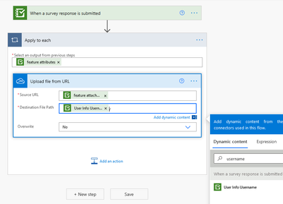

@IsmaelChivite , can you provide an example of uploading file to SharePoint list? I'm having trouble figuring out what value I should provide for the file content parameter of the Add Attachment action?
ILoveMap
@IsmaelChivite , can you provide an example on how to specify the target folder in OneDrive using human friendly paths? I'd like to save photos to go into a separate folder for every user then sub folder for a specific record. I'm a little lost on how to get the username value from userInfo and pass it as a parameter to construct the target path.
Thanks for all of your helpful content and guidance!
MichaelBruening
@ILoveMap The idea is that you are replacing a portion of the path to the OneDrive folder with certain "questions" from your survey. In the last example above, the "Destination File Path" is using the answer from two separate questions to create or deposit photos into the OneDrive system.
Within the "Upload From URL" module, you would click into the "Source URL" and then within the "Dynamic Content" dialog, you could do a search for "attachments" and then from the resulting list choose the "feature attachments "Name of your question that allows attachments" URL".
Then you would click into the "destination File Path" and then from the "Dynamic Content" dialog you would then choose the questions that you want to use in constructing folder path of where the photos would be uploaded to. If you want to use the "username", then you could do a search for "username", then choose the "User Info Username" content, then place a "/" and then choose the next question that you want to use within the folder path that is being created.
For example if you want to use the "username" and then an question for a "Unique ID", then within the "Destination File Path" you would select from the "Dynamic Content" dialog the "User Info Username", then type a "/", then select from the "Dynamic Content" the "Unique ID question".
Select the URL -
Select the Username information
Add in the "/" with the next question within the folder path.
You can add as many questions as you want, but you will have to determine this based on how your survey is setup and how you want to divide up the photos.
I hope this help you and once you start to understand how things work, then you can do some really great things.

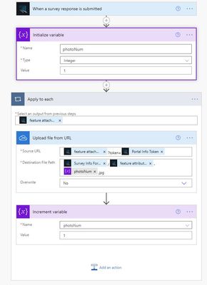

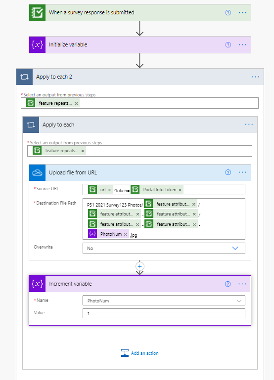

CameronRex1

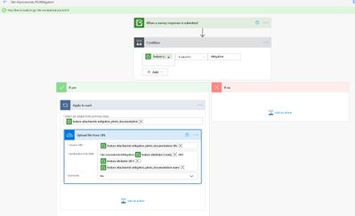

@IsmaelChivite, for uploading attachments (in this case images) to OneDrive, is there a way to increment the file name in order to support multiple images that reside in a "multiline" Survey123 image field?
In the example shown, the flow fails if the attachment has more than one photo (if overwrite is disabled) or only the last photo of a "multiline" enabled image field (if overwrite is enabled).
I currently have the Destination File Path set as [FormName]/[ResponseName].jpg, but this results in flow failure or overwriting the image if multiple images exist in a multiline image field.
I'm trying to figure out how to make the Destination File Path set as [FormName]/[ResponseName]-[IncrementedValue].jpg
On a side note, in the example, for images, shouldn't ".jpg" be appended to the end of the Destination File Path, otherwise it is saved without a file extension.
CameronRex1
@IsmaelChivite, I answered my own question.
For multiple images contained within a "multilline" enabled image field, the easiest method is to Initialize a variable, say "photoNum" outside of the Apply to each. Then in the Apply to each, use the same Upload file from URL. Set the Destination Path with [Directory]/[Name]-{photoNum}.jpg and then after the Upload file from URL, but within the Apply to each, add Increment variable with the Name set to your variable "photoNum" and Value to 1.
Note: My Survey123 icons look different because I have it set up as an Enterprise Connector. Just in case anyone is confused.
 I hope this helps.

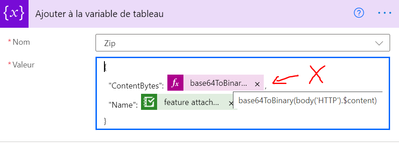

One other point is that if the survey doesn't have any attachment the flow will fail as it is expecting a list (even an empty list would do), instead of null.  To handle this you need to put in condition like "equals(triggerOutputs()?['body/feature/attachments/photos'],null)" and only process the attachments into the array of attachments if this value is not equal to true or is equal to false.  The other path through the condition doesn't need to do anything as the array variable will be empty and no attachments will be added to the e-mail.

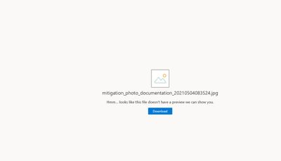

BobSteiss
Hello.  I have set up a flow using Ismael's example and it works great to send my 2 jpeg photo attachments collected using survey123, via email, to my email account, however, I cannot open the jpegs.
I tried saving them to my desktop and opening them from there but got the same message.
Has anyone else experienced this issue and if so, can I ask how you solved it?  Could you please share the code you added or a picture of what you had to add to Ismael's flow to keep flow from corrupting the jpegs?  The photos look great in survey123.arcgis.com so I am pretty sure the problem is occuring during the flow.  Thank you.
DavidClark9
@BobSteiss
As noted above you need to use the base64ToBinary function i.e."base64ToBinary (body('HTTP').$content)".  Image files are binary but the data is transmitted via HTTP as base64.
Thanks,
David.
BobSteiss
Thanks David.  I inserted the code you provided and now the attachments are coming through great.

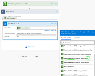

joncroley
@IsmaelChivite
I followed the process, however when I execute the flow it will upload the files to OneDrive, but when one tries to view the photos or even view them it states the file format cannot be displayed. There are multiple images that could be with the survey (max of 5). Am I missing something?
IsmaelChivite
Esri Notable Contributor
@joncroleyYou were not missing anything. I was! In the original text of the article, the expression for contentBytes was incorrect. It was body('HTTP').$content but it should be base64ToBinary (body('HTTP').$content).
I edited the text and animation to reflect the correct syntax. Sorry about that.  @DavidClark9 and @QPWS_SpatialServices already had pointed that out in comments.

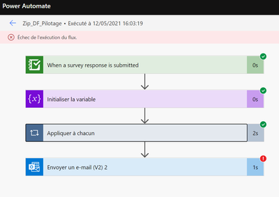

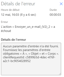

José_LuisCc
Hola @IsmaelChivite ,
he seguido paso a paso tus instructiones pero llego a un punto que no entiendo. Es al momento de enviar el correo.
Basicamente dice que no ha recibido ningun parametro.
El problema se produce cuando hago Switch para cargar la variable exactamente.
si NO activo el switch  y no cargo la variable, el flujo funciona correctamente...... pero sin archivo adjunto.🙄
José_LuisCc
@José_LuisCc
@IsmaelChivite He encontrado la causa :
Ha funcionado sin hacer la conversion
Gracias @QPWS_SpatialServices
ILoveMap
@MichaelBruening @IsmaelChivite
Thanks for your help! I was able to get the flow working to save photos in nested folders. I'm wondering if you could provide some insight on how to execute this flow when the survey photos are in a repeat. I'm having trouble getting the flow to work properly in this case. I believe there is an issue with what I have entered in one (or both) of the apply to each connectors. Thanks again for any insights you may have.
MichaelBruening
@ILoveMap I have not worked with Power Automate as much as Integromat. I would imagine that you would have to recreate the API call of "Query Related Records" and then Query their related Attachments.
For the second repeat you would have to "Query Related Records" and then query the related records of the first repeat, and then finally query the attachments of those related records. Keep in mind that you would have to iterate through each level of the each repeat in order to get all of the related records. I know within Integromat that it takes a little doing, but I am unsure of the correct workflow within Power Automate.
From your screen shot it appears as though "apply to each" is similar to an "iterate" within Integromat? It looks as though you may need to the HTTP and append Array modules added into your flow, similar to the what Ismail demonstrates within the article?
Sorry I could not provide a definitive answer.

MichaelBruening
Houston, we have an issue! It appears that Microsoft has decided to make the HTTP module into a "premium" one? This is tends to put a small kink in the plans of those that would like to use it and have no control over the decision making process for enabling them.
Anyone have an idea around this by chance? It appears as though a lot of things have changed with the pricing structure of Power Automate as well; kind of similar to Integromat plans.
I am guessing the single license would be the route to take in this instance with myself being the only person to use this?
Thanks in advance.
Mike
abureaux
MVP Frequent Contributor
@MichaelBrueningYou are correct. You only need one creator in your company for Power Automate. The rest of the users can benefit from your flows without one.
Honestly, this method makes the most sense. Ideally, you want your development environment to be "headless" so if "that one guy" leaves, your whole house of cards doesn't come tumbling down.
Yes, they did and we had to get our processing account uplifted to use the capability. All up we have found it so hard to work in Microsoft land compared to Integromat but it is the only supported environment in our agency.
abureaux
@QPWS_SpatialServicesMay have been a good move depending on your environment. Portal 10.9 wasn't compatible with Integromat. I didn't check if they fixed it in 10.9.1, but I have completely transitioned away from Integromat at this point because of that bug.
Speaking as someone that was forced to move from Integromat to Power Automate, it was a little annoying at first, but it actually gets pretty easy and can be a far more robust and dynamic environment. It 100% has its quirks though.
MichaelBruening
@abureauxI spoke with my IT department (which is an outside consultant) and they stated that I would have to have my boss send over a request to enable the account. I thought I would wait until after the new year to do so, since they are out on PTO.
I really like the fact that Power Automate will use "Human Friendly" folder names/file path construction within the OneDrive environment. I would have to data mine the "computer friendly" folder ID on preestablished folders within my OneDrive and then use a pulldata() populate hidden fields that directed my data where it needed to go. It was a really slick setup a few years back and worked flawlessly, but a ton of footwork on my before field work began.
DanielArsenault
How can you specify the token for UPLOAD FILE FROM URL,  my attachement images are appearing as unreadable, but it does create the file.
Amarz
Is there a way to do this without the Power Automate Premium addon that you are aware of?
abureaux
Not that I am personally aware of. Mainly because of the HTTP steps. Sorry 😞
