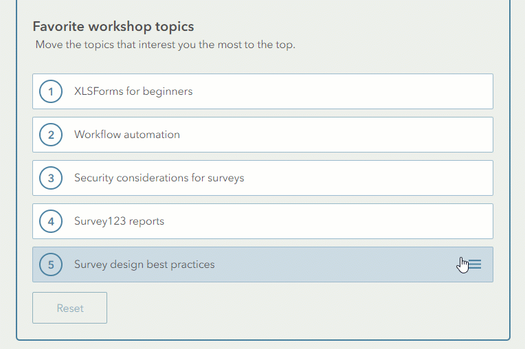

The ranking question lets people sort items in a list in order of preference. Here is an example where we ask respondents to rank a series of topics for an upcoming Survey123 workshop. Note how the ranking of a topic in the list can be changed by simply dragging it to the desired position. Users promote their favorite topics to the top of the list.

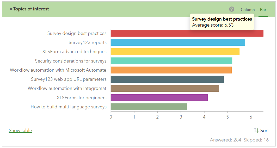

As the user submits the survey, choices in the ranking question are scored accordingly to their position in the list: The higher in the list, the higher the score. Survey123 lets you analyze survey responses to understand the average and variance of the scores for each item. The chart below shows preferences showed by respondents. The "Survey123 design best practices" ranked first with an average score of 6.53, followed by the "Survey123 reports" topic.

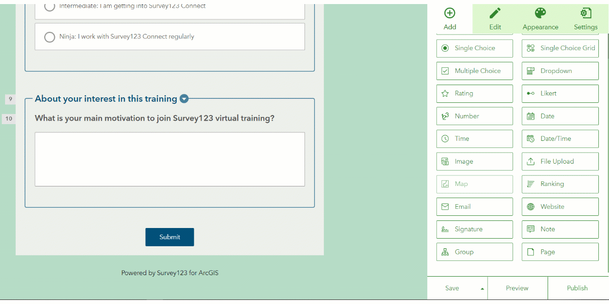

The Survey123 web designer lets you visually build your own surveys from a web browser. To add a Ranking question to your survey, drag it into the design preview. You can interactively add choices to the list, or add them in bulk as shown in the animation below.
Adding too many choices to a Ranking question will be overwhelming to users. It is recommended that you do not add more than 6 choices.

When you look at the results of your survey in the Survey123 website, you will be presented with a chart and a table. The chart sorts your choices using the average score. It also shows you the number of responses, and the number of times the question has been skipped (if appropriate). Here is an example. This chart will give you insight as to who are the winners, overall.

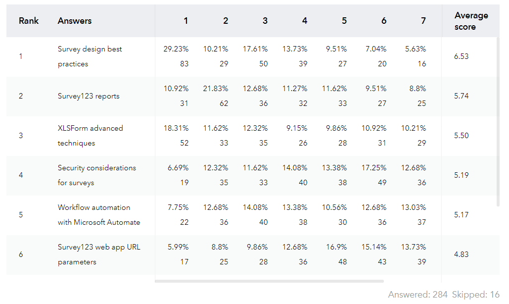

The table is useful to understand the variance of the rankings. The table indicates what the average score is, and how many times a particular choice was ranked at each position.  For example, in the table below we see that the 'Survey123 design best practices' topic was selected as the top choice by 83 of the respondents (almost 30%).  We also see that while 'XLSForm advanced techniques' ranked third position, it was chosen as the first choice by a larger group than 'Survey123 reports', which ranks second.  This tells us that on average, the Survey123 reports topic is more popular than 'Advanced Techniques', but proponents of 'Advanced Techniques' care proportionally more about the topic.

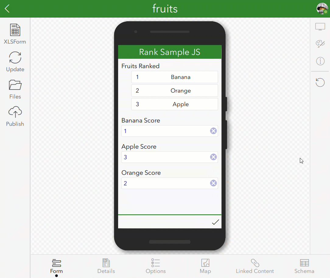

Keeping this in mind, you can do a few clever things with XLSForms. A common request is to be able to store the score of each choice as an attribute. Here is what I mean. Note how the scores for the fruits automatically calculate as the choices are ordered:
Once you know how to get the score of an item, you can use these values to implement your own custom validation or skip logic.
