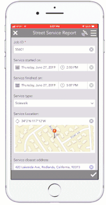

In the Street Service Report survey example in the right side, you will appreciate that the photo taken from Survey123 automatically includes the Job ID as well as the date and time when the photo was taken.
This information is part of the image, it is a photo watermark.

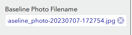

Carrie
I've successfully gotten multiple attributes and information to show up as multiple watermarks on my photo, but I am having trouble getting the photo name to show up in the watermark. Instead, it looks like it's the xpath that is showing up instead of the name.
I have site_id being created from the time stamp of the survey then it is fed into the attribute1 question to be used in the watermark.
After the photo (baseline_photo) is taken and a name is generated, I have it going into a variable question b_photo_filename. Then I call the variable (b_photo_filename) in the watermark along with the site id.  I know it is collecting the photo name because I have changed the question type to text, and I see the photo name in the b_photo_filename box.
The site id shows up correctly, but instead of the photo name, it's like I am getting the whole xpath name.
Can anyone or @IsmaelChivite  tell me why or what is wrong with my expression that it makes the photo name shows up this way?
