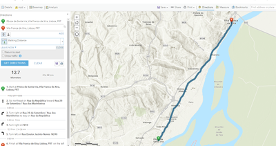

SIG-EscutismoCNE
Hello @IsmaelChivite ,
is it possible to place the map at a distance of two points in Survey123 Connect, as arcgis online does?

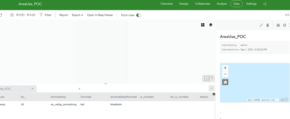

I've set up my survey with geoshape question that includes a repeat and a nested repeat
geoshape
     repeat table
               repeat table
I intend users to use the inbox as you describe in the section above: Geotrace and geoshape in the Survey123 field app Inbox.
Everything seems to be working as expected except that the nested repeat (table related to the table) will not allow additions when queried from the inbox.  The first repeat does (that is related to the shape), but the repeat within the repeat only loads the data and there is no "+" on the record selector to add records to that nested repeat. It's acting as if that child table has a one-one relationship with the parent table.  I downloaded the service to a GDB just to check that and it is set up properly with a one-many relationship between those tables.  Any ideas are appreciated as this is what I need to work for my users.
