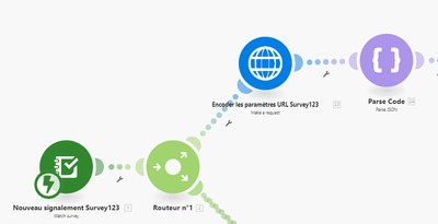

MatthieuANDRE
Hi Ismael,
Is it possible to do the same thing with Integromat ?
Thanks

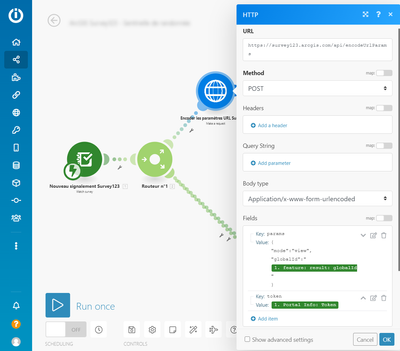

hgaignard

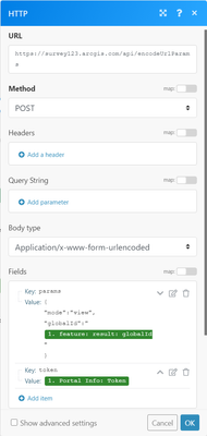

@MatthieuANDRE, you can use Integromat with HTTP Module (Make a request) + JSON Module (Parse JSON)
HTTP request details :
MatthieuANDRE
@hgaignard, thanks for the workflow
How should I configure the Parse JSON module ?

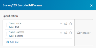

hgaignard
@MatthieuANDRE, you need to generate a data structure with the response from the Survey123 REST API. Use this example response in JSON Module > Parse JSON > Add Data structure > Generator:
 "code": "ShBmaWVsZDpjdXNUcmFja05vchRmaWVsZDpjdXNUcmFja05vPTEyMw==",
 "success": true

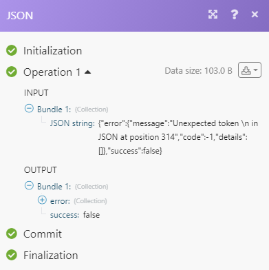

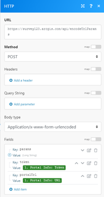

TimLiponis
@hgaignard  I am trying to do this as well within integromat using ArcGIS Enterprise with the following parameters:
But when I try and run the scenario and parse the response using the JSON as you described above, I am getting the following error:
Any thoughts on why this is happening?
Thanks!

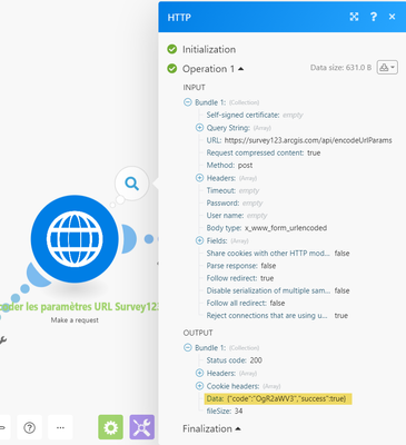

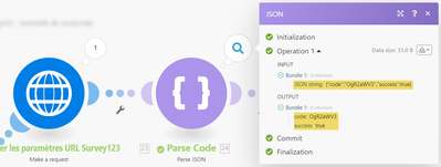

hgaignard
Hi @TimLiponis
First : Does your HTTP module works ? On your screenshot, I don't see the value of the params field in your HTTP request. It should appear like this :
To make sure your query works, launch your scenario and view the output of your HTTP module.
Secondly : Check your generated data structure with JSON module. Integromat > Data Structures > Your Data Structure Name > Edit. It should look like this.
