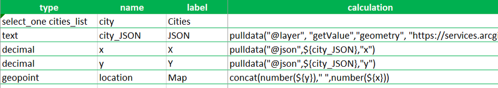

Calculating the geopoint
Next, we are going to calculate the geopoint question with the geometry we have from the selection. Note how the pulldata('@json') function allows us to easily extract the x and y coordinates from the JSON, and how the concat() function is used to compose the actual geometry in the geopoint question.
Technically, you do not need to add the x and y questions into your design. You can construct the geometry object all in one expression:
concat(number(pulldata("@json",${city_JSON},"y")), " ",number(pulldata("@json",${city_JSON},"x")))

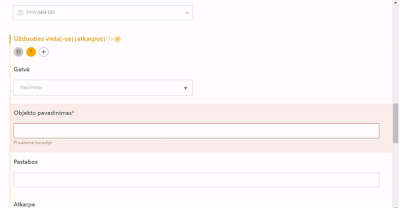

  • Polygons and Lines: It is technically possible to create a geolist that stores a polygon or line geometry as well, but this only works in the mobile application.
Well, we got this working in web forms too! 😀
We create street or park geometries from a geolist 😊
