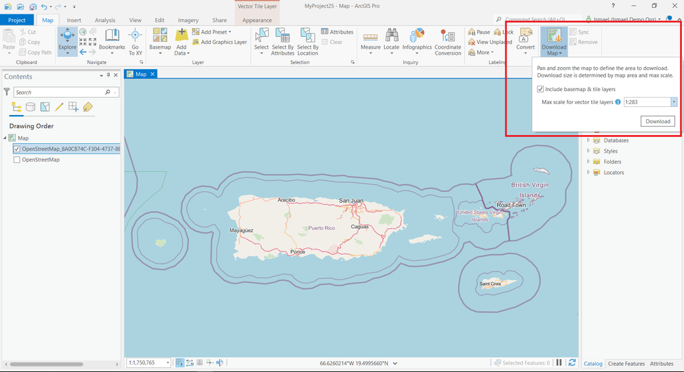

The simplest way to create an offline map in ArcGIS Pro is to use the Download Map option in the Map ribbon.  You can use it, for example, to take a small portion of an Esri basemap into an offline map file.
Open ArcGIS Pro, select the basemap you want to take offline and zoom to your area of interest.
In the Map ribbon you will find a button labeled Download Map. Use it to download the current extent of your map as a file.
In my case, I wanted to create an offline map of the island of Puerto Rico using the OpenStreetMap basemap.
The output .vtpk file of Puerto Rico, with the maximum level of detail possible, took 25 minutes to create on my laptop and had a size of 120 MB.

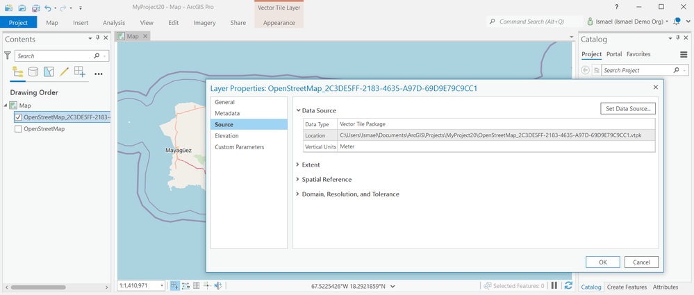

Once created, the offline layer is added to the table of contents in ArcGIS Pro. From there, you can find the location of the file through the layer's properties dialog as shown in the next screenshot.
In preparation for our next step (Upload your offline map file into ArcGIS), you may want to rename the file.

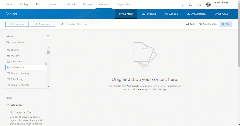

Using a web browser, sign in to ArcGIS. From the Content tab, click on New Item and upload your offline map. As you go through the steps in this dialog, make sure you choose the option to upload the file only. Do not create a hosted tile layer as it is unnecessary. Here is a step by step animation so you can see the process.
After the item is created, I like to change the thumbnail, summary and description. I also make sure that the item is shared with all relevant ArcGIS groups that will use this offline map in Survey123.

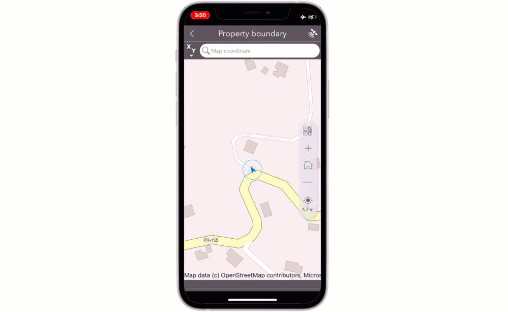

Use the offline map from the Survey123 field app
Once linked, offline maps can be downloaded in the Survey123 field app and then used while disconnected, as shown in the next animation.
