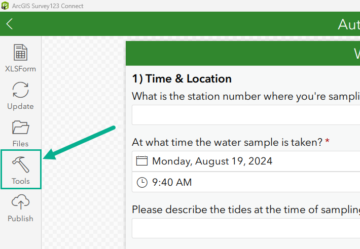

Survey123 contains tools that assist with some of your form authoring tasks. When publishing surveys in Connect, you may have noticed the Tools button in the side panel.
If you see this button in your Connect window, fantastic! You can skip to the next section and start preparing your XLSForm for automatic translation.
If you do not see the Tools button, you will need to complete a couple additional steps to get access to the tools in Connect. To set up, follow the steps outlined in the Configure tools in Survey123 Connect documentation so you can run the Auto-translate tool.

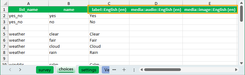

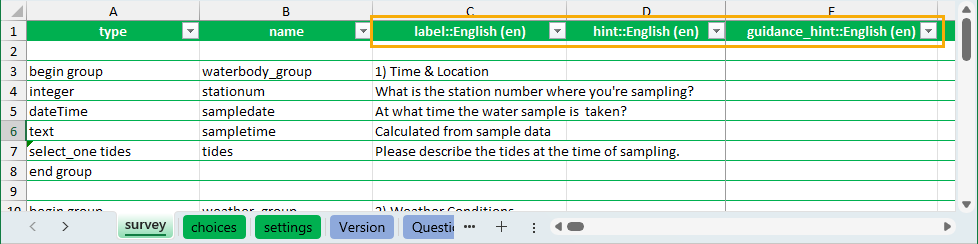

With the default_language defined in the settings worksheet, now you need to update all the default translatable columns in your survey and choices worksheets (don't forget your choices worksheet!). For best results, all columns that can be translated should be updated with the language and locale code that matches your default language. This includes the following columns:
  • label  ➡️  label::English (en)
  • hint  ➡️ hint::English (en)
  • guidance_hint   ➡️  guidance_hint::English (en)
  • required_message  ➡️  required_message::English (en)
  • constraint_message  ➡️  constraint_message::English (en)
  • media::audio  ➡️  media::audio::English (en)
  • media::image  ➡️  media::image::English (en)
Don't forget choices:

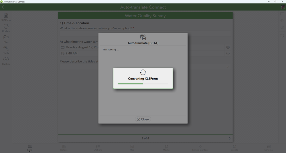

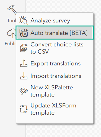

With your survey opened in Connect, click the Tools button in the side panel and choose Auto translate [BETA]

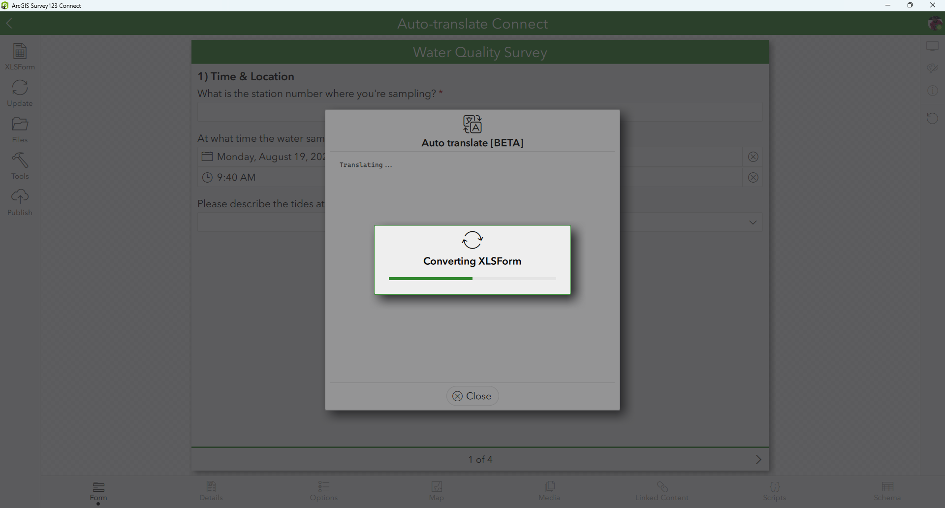

The tool will run for a few seconds to a minute or so, depending on your network connectivity, the size of your survey, and the number of languages you are translating. When the tool finishes, you will see the Converting XLSForm message (because the tool has modified and saved your XLSForm) and Connect automatically refreshes your form preview.

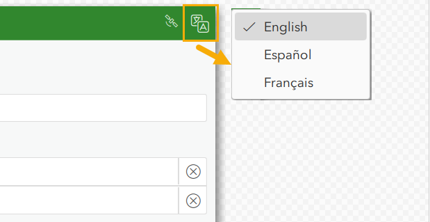

When your form finishes converting, you will see the language switcher on the top of your form, which allows you to choose between your default language and the additional languages that were automatically translated.
It is necessary to thoroughly review the results of the Auto translate [BETA] tool. Machine translation is not 100% correct and will require human review and verification.
