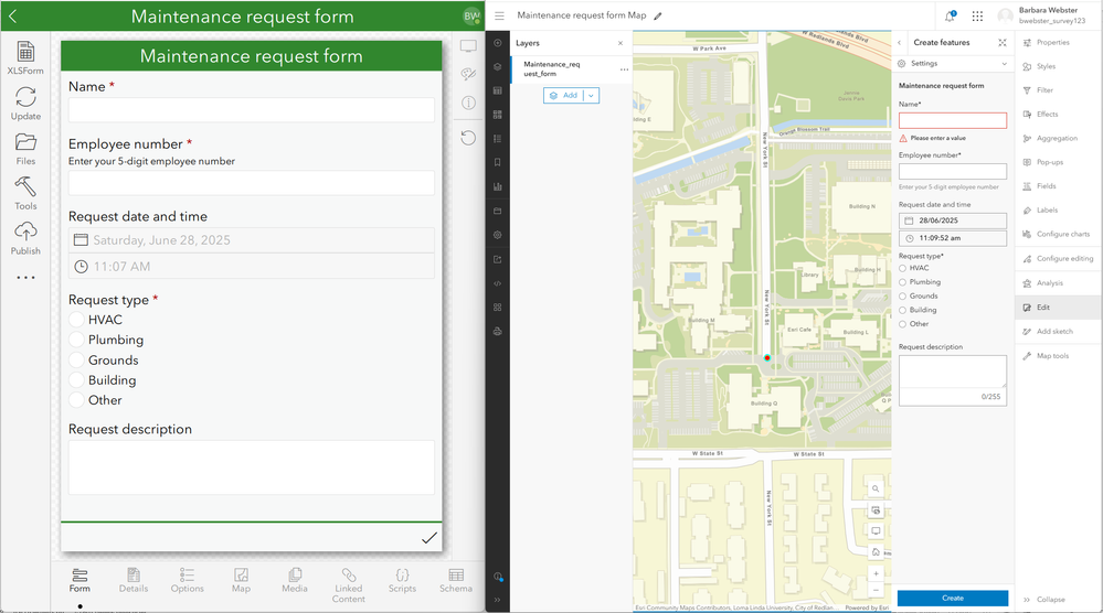

Map with forms – Web maps support configuring forms that are stored in the web map and that allow editors to view or edit fields within the feature layers or tables. These web map forms can be used by a few different ArcGIS apps, including ArcGIS Map Viewer, ArcGIS Field Maps, and ArcGIS Web Editor.
The tool converts Survey123 questions to their closest equivalent feature form element and properties. If a question type or question property does not have an equivalent in the web map form, that question or property will not be included in the form. For example, a rank question has no equivalent in the web map form. While the field associated with a rank question will still exist in the feature layer, no element will be added to the web map form. A detailed export summary lists which questions were converted, partially converted, or not converted, as well as additional conversion notes.

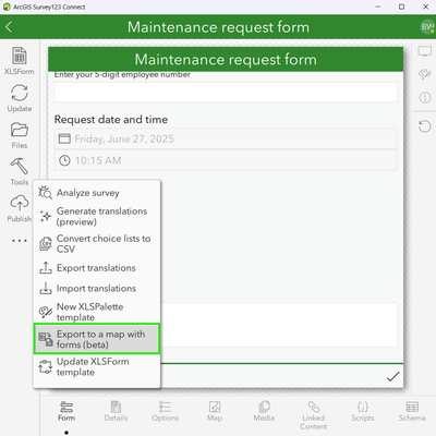

The tool is located in Tools menu of Survey 123 Connect.

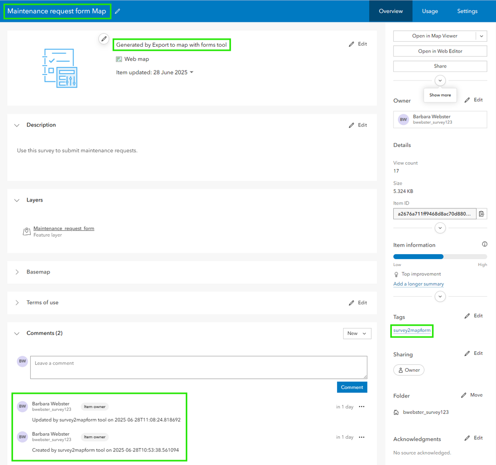

When the tool is run for the first time, it creates a new web map with the same name as your survey item and “Map” appended to the end. The new web map includes a tag (survey2mapform), summary, and comment that indicate that the web map was generated by the tool. The tool adds the feature layer or feature layer view to the map, as well as any related layers or tables. It then creates one or more forms in the web map. Multiple forms are created if the survey contains repeats, and the form is saved in the web map (not the feature layer). The saved form contains elements that are equivalent to the questions in the survey.
When a survey author runs the tool again, the generated map is updated with any applicable survey edits. The tool checks the survey's related web maps for the unique tag (survey2mapform) to determine if there is a corresponding map to update; otherwise, it creates a new map.
