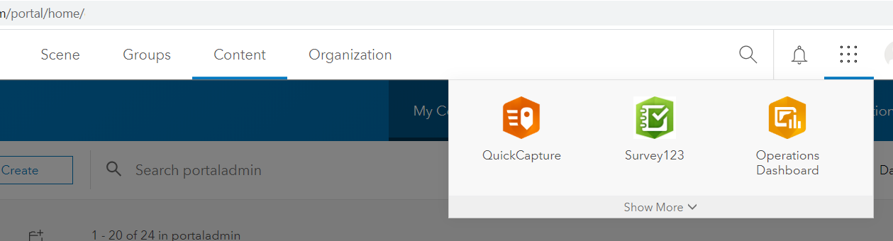

While you can obviously bookmark the URL above to reuse it, it is much better to modify your ArcGIS Enterprise app launcher to include a shortcut to the Survey123 website. That way, anyone in your organization can easily access the Survey123 website without having to remember the syntax of the URL.
You will find step by step instructions to create your own Survey123 website shortcut in the app launcher of ArcGIS Enterprise in this Technical Support Article.
