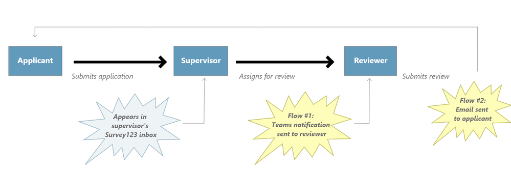

This workflow follows a right-of-way (ROW) application that must be reviewed and approved prior to construction work.
The workflow consists of three surveys that are all submitting to the same feature layer:
1. An application survey
2. A review assignment survey
- This survey contains all the questions that are in the application survey with some additional questions that track the review status.
- The inbox is enabled with an inbox query that shows all surveys that have not yet been assigned to a reviewer.
3. A review survey
- This survey is identical to the review assignment survey except that the inbox query is set to only show the surveys assigned to this reviewer.
 As the workflow progresses, there are two Microsoft Power Automate flows that are run, resulting in two notifications:
Flow 1 – Runs when the survey is assigned for review and sends the assigned reviewer a message in Microsoft Teams providing links to open the assigned record in the field app or web app.
Flow 2 – Runs when review survey is submitted and sends the applicant an email notifying them of the results of the review.
