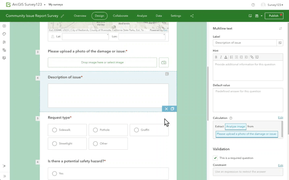

Generate a description for the uploaded image – image analysis
  1. Select the question “Description of issue”, and set its calculation to “Analyze image”, based on the “Please upload a photo of the damage or issue:” question.
  2. In the textbox “What would you like to extract from the image?”, enter the following prompt: Analyze the image and write a short 311 issue description. Identify the damaged public asset (e.g., sidewalk, road, park equipment), its location in the scene, any obvious safety hazards, and the necessary action (repair or maintenance). Describe only what is visually present.
In XLSForm, use the following expression for the calculation of the question “Description of issue”:
  • pulldata("@ai","image2text",${photoDamageOrIssue},"Analyze the image and write a short 311 issue description. Identify the damaged public asset (e.g., sidewalk, road, park equipment), its location in the scene, any obvious safety hazards, and the necessary action (repair or maintenance). Describe only what is visually present.")

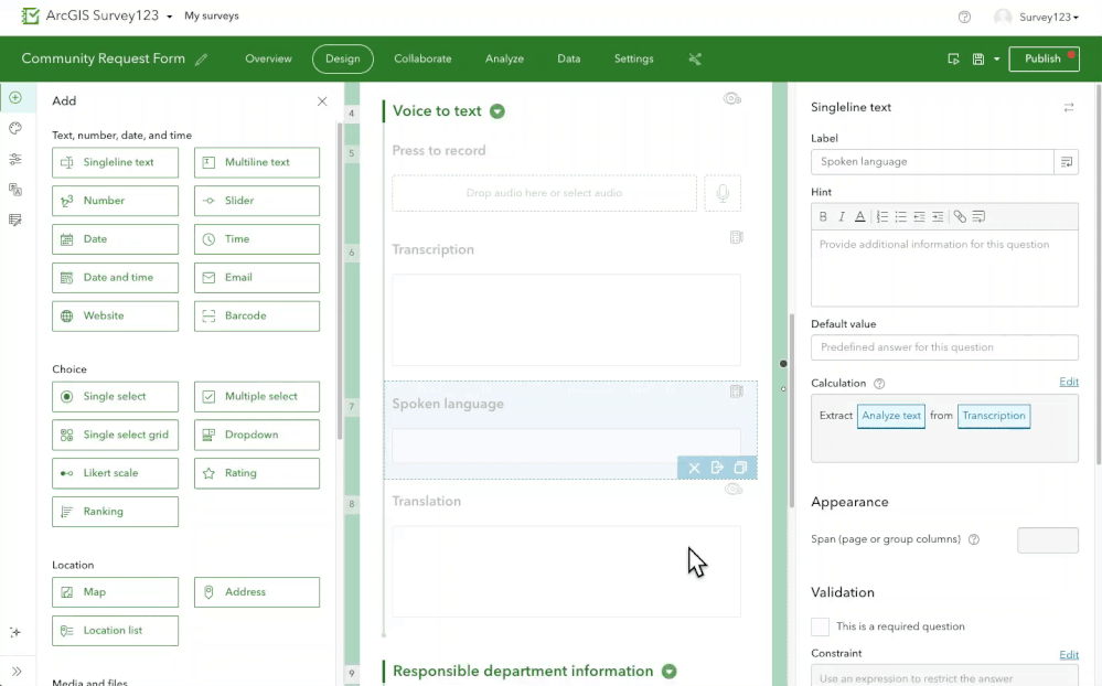

Transcribe audio to text – audio transcription
  1. Select the question “Transcription”, and set its calculation to “Transcribe audio”, based on the “Press to record” question.
  2. Leave the textbox “Transcription prompt” empty.
The prompt for audio transcription is optional. It's mainly for improving spelling accuracy on specific words, for example, "Esri isn't transcribed as Ezri". For most audio, this can be left empty.
In XLSForm, use the following expression for the calculation of the question “Transcription”:
  • pulldata("@ai","audio2text",${press_to_record},"")
Translate non-English text into English – text analysis
  1. Select the question “Translation”, and set its calculation to “Analyze text”, based on the “Transcription” question.
  2. In the textbox “What would you like to extract from the text”, enter the following prompt: Translate the input text into English. Only output the translation result.
Since we don’t need to translate if the respondent speaks English, we can set the “Translation” question to be visible only when “Spoken language” is not English.
