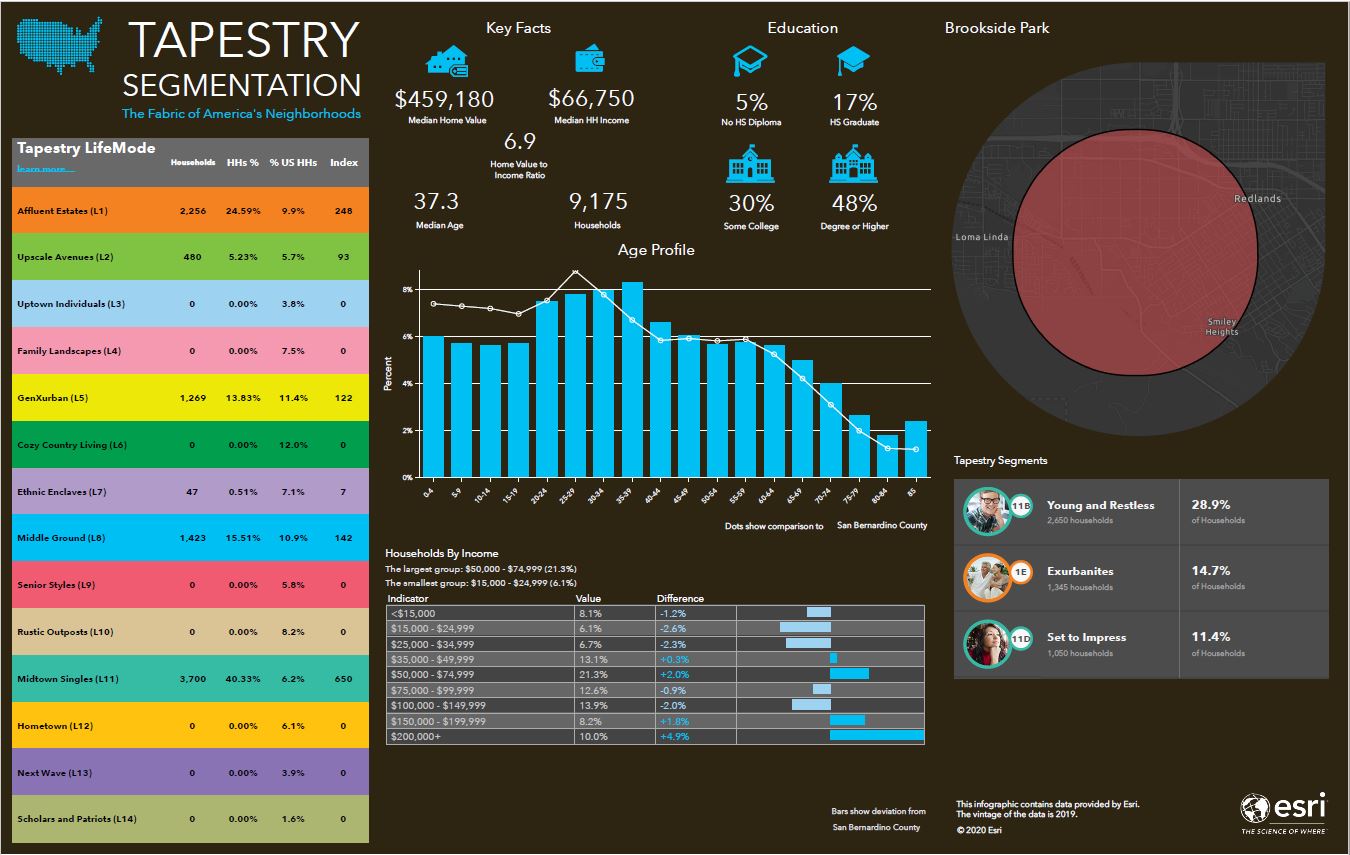

In this blog post, I will describe how to analyze your Survey123 results using the Business Analyst Online Reporting and Infographic Services to further understand your data and extract additional information that may not easily be apparent in your survey results. The Infographics or Reports obtained from Business Analyst Online can then be exported and used in larger applications. Infographics can be exported as PDF, an image, or Dynamic HTML that can be embedded into another website. Reports can be exported as PDF’s, Excel documents, or both. The example below shows the default Tapestry Segmentation report for an Area of Interest, although both Infographics and Reports are highly customizable to look how you like and can include a wide variety of available data that can be viewed from this data browser.
SampleInfographic

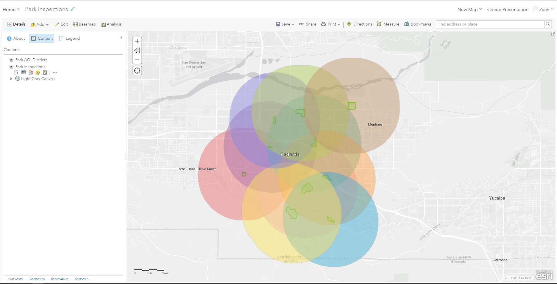

Once the park data was collected in the hosted feature layer since the GeoShape question type was used to outline the park boundaries, the service was pulled into a Web Map to define areas of interest surrounding the data. Unfortunately, Rings can only be added to center points in Business Analyst Online so the areas of interest needed to be specified using the Create Buffers tool in the Web Map’s Analysis tools.
WebMap with Buffers

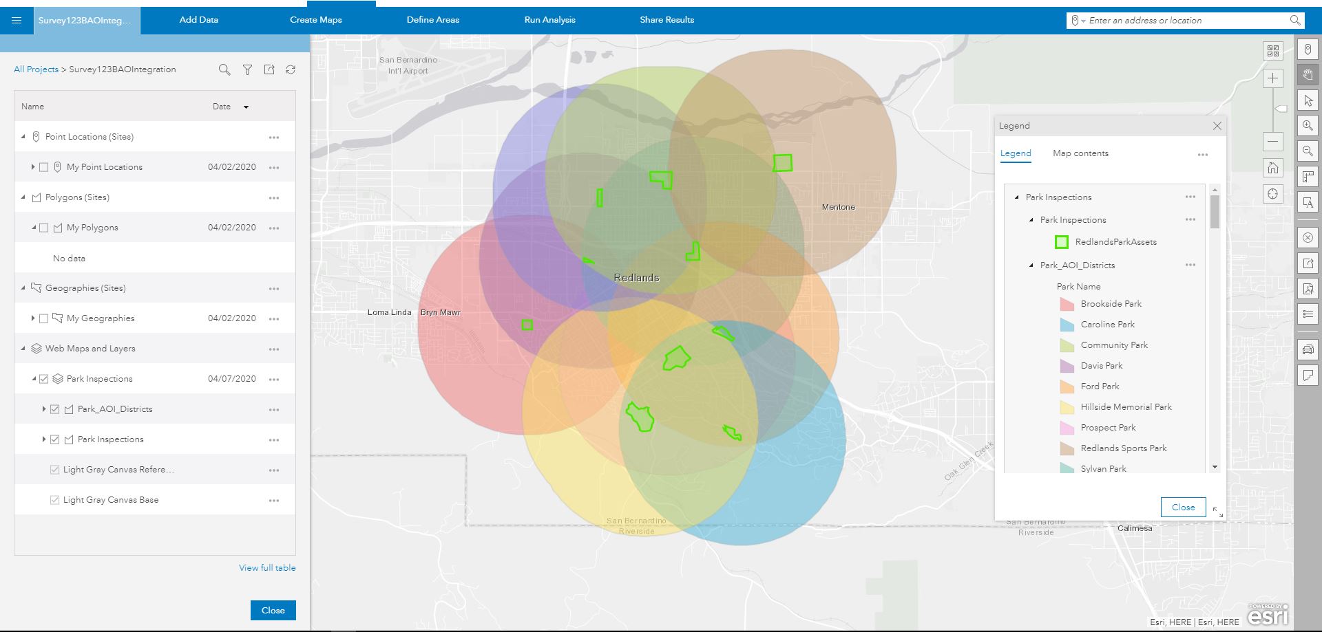

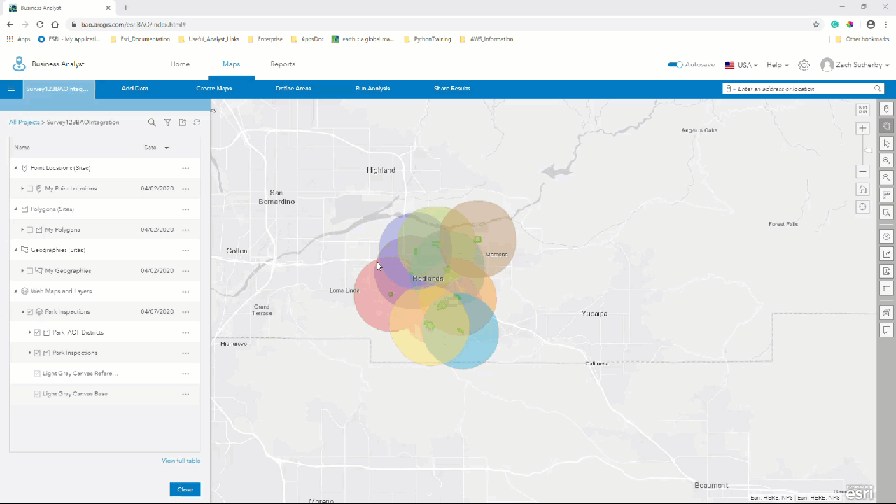

A new Business Analyst Online project was created and the Web Map was imported into the project.
After pulling the Web Map into Business Analyst Online areas can be set up to be used in Reports or Infographics.

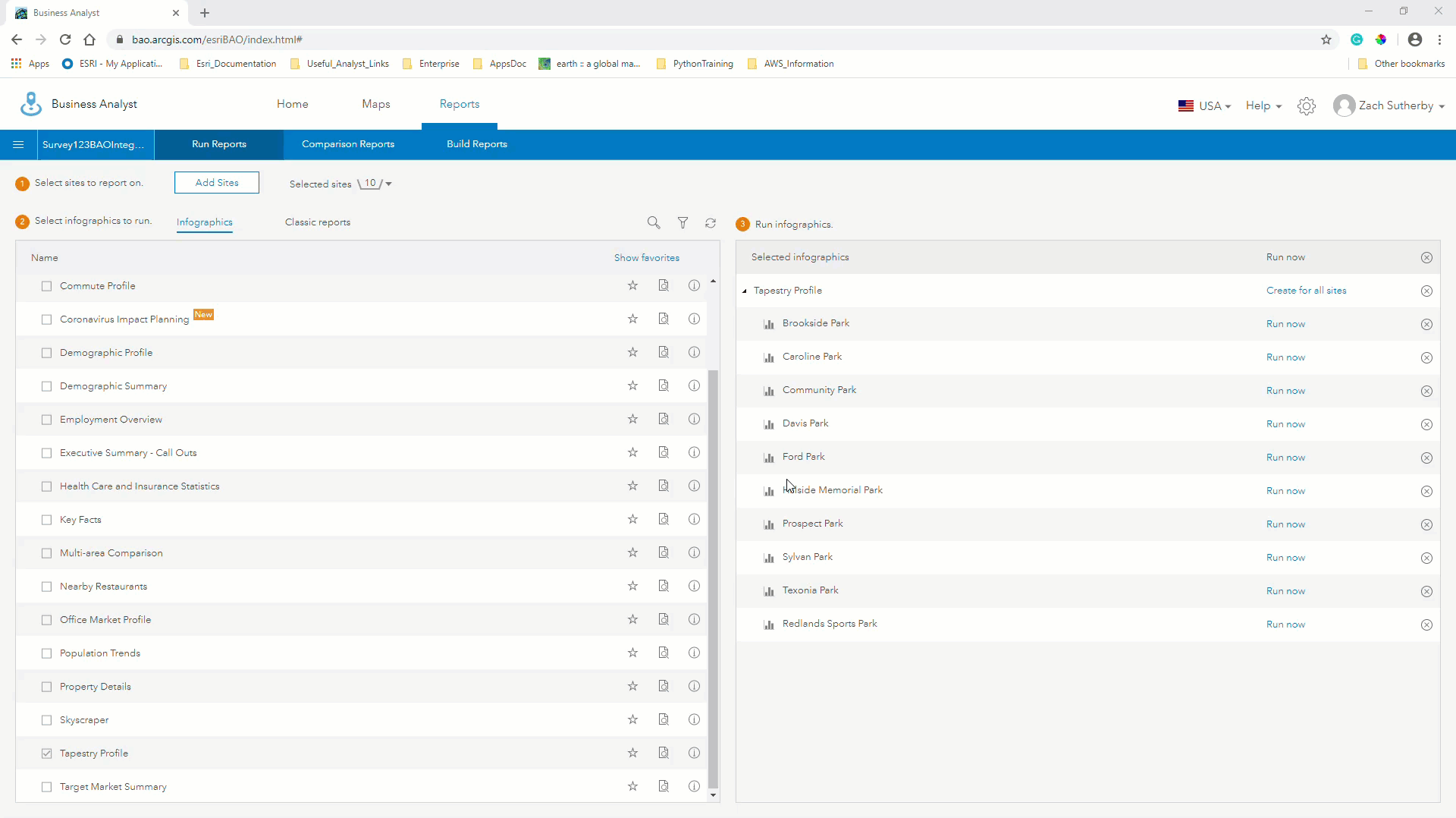

Once the areas are configured any Reports or Infographics that were created or shared with me can be run with my survey results.
Final Infographic

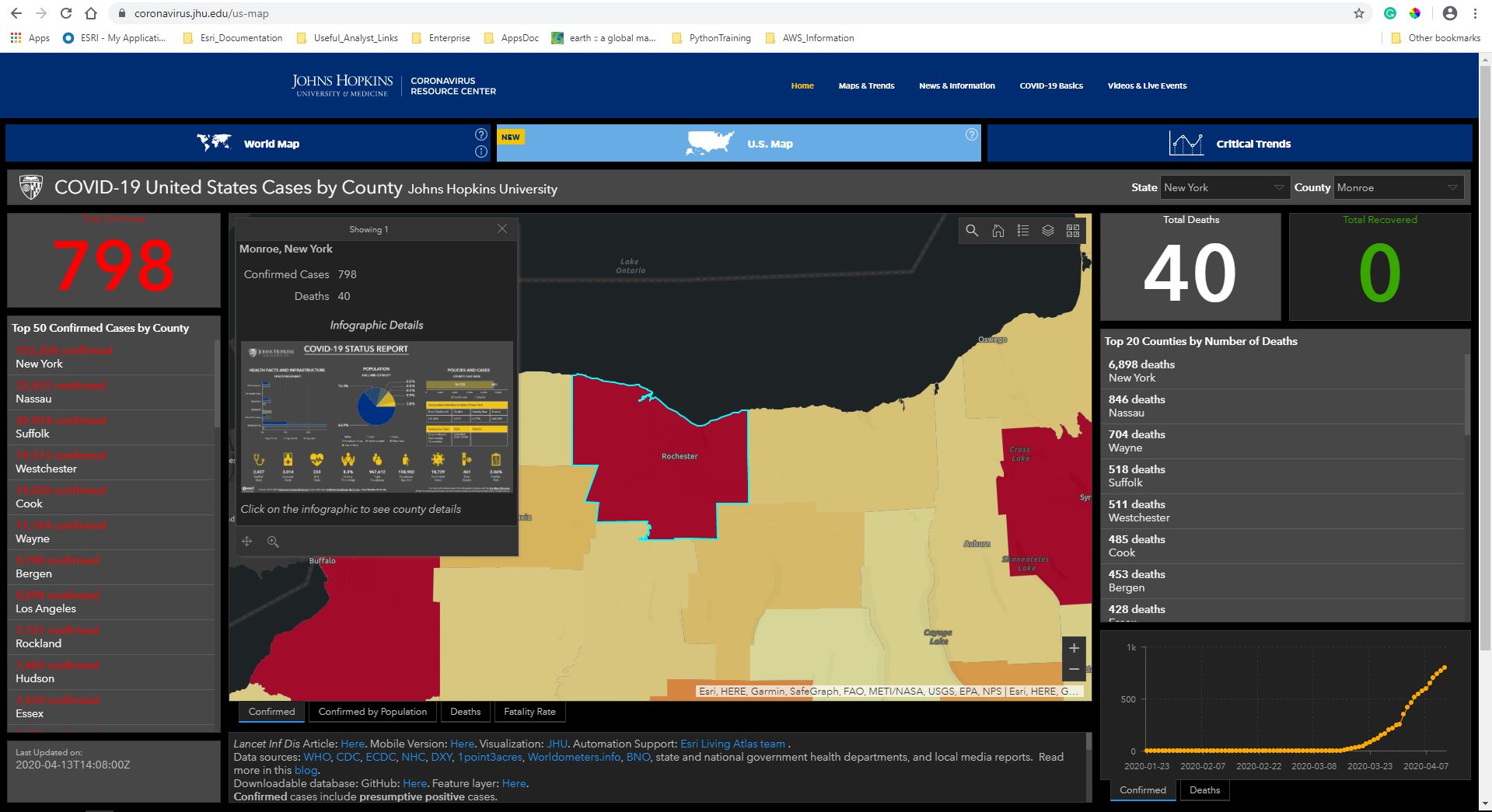

The geographic results of these projects can be further assessed using the tools present in Business Analyst Online. For example, the John Hopkins Coronavirus dashboard has recently implemented a U.S. Map section that utilizes the COVID-19 Status Reporting Infographic present in Business Analyst Online.
  JohnHopkinsDashboard
John Hopkins University is using County polygons to run these reports, but the workflow outlined in this article can be used to make connections between your Survey123 results and the socio-economic factors around your data. Dashboards and Web Apps are great options to highlight those connections and shared across organizations.
