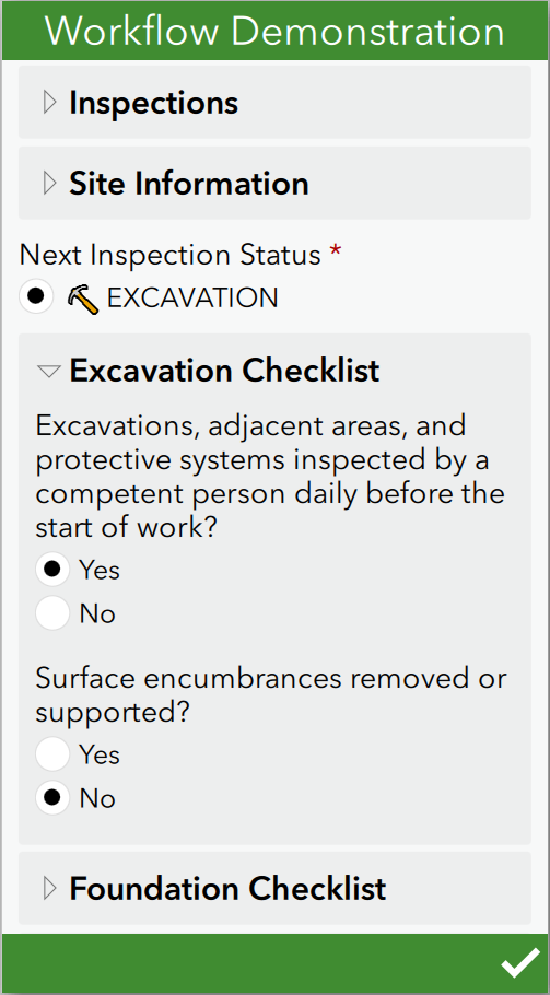

So how does the end result work? Lets take a look:
In the above screenshot the following can be seen:
  • The survey initialises with only the Excavation status being visible in the select_one question. The inspector is not able to select any other status.
  • The survey only has the Excavation Checklist enabled
  • The inspector cannot skip a status or go back to any other status
  • The inspector cannot complete any other checklist of the survey - only the active status' checklist

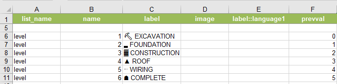

We need a way to only allow the inspector to choose one "next" status and this needs to be based on the "current" status. So we need a select_one that is filtered according to the "current" status:
Notice that we added a filter column called "prevval" to the choices for the "level" list. In this example "level" refers to the status of the inspection. Also you will notice that the levels run from 1 to 6 and the corresponding "prevval" filter is one level behind. So if the "prevval" or current status is zero (0) then the list will filter and only show Excavation as an option.
