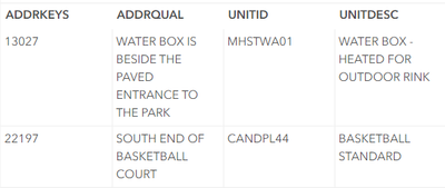

I know your post is from a while ago, but I'm looking to do the same thing, I have asset IDs that I want stored as the value, but for the user they want additional information in the drop down list.
You say you mostly resolved it by changing the name and label fields on the choice list, how so?
Would it be possible for me to have it query the layer and combine two fields? Like (UNITID)+(Description)?

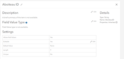

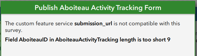

@IsmaelChivite What happens when you are developing a choice list from a feature layer service and the field name list place holder variable is longer than the acceptable length of any input value?
My example is, I am using the select_one AboiteauIDs. The feature service field name that I need is AboiteauID. My apperance section is
autocomplete search("AboiteauID?url=https://services6.arcgis.com/LToPLrsKQBrQZIJZ/arcgis/rest/services/Aboiteaux_with_Tracking_(View)/Fe...")
In the choices section the list name is AboiteauIDs with AboiteauID for the name and label. I have a max value length for this field as 9. The choice list works but when I go to publish the form, I get the error:
Any way I can get around this without having to change the accepted field value length?
abureaux
MVP Frequent Contributor
@ChrisJRoss13You set your field length to "9" in S123 Connect and are trying to publish to a preexisting feature layer. In that preexisting feature layer, your field length is not "9". Go to the feature layer in Portal and check how long the field length actually is. You can change your preexisting feature layer to be "9" and then go back to Connect and re-publish.
To do this...
  1. Go to your Portal
  2. Locate the Feature Layer and open it
  3. Click "Data" then "Fields"
  4. Locate AboiteauActivityTracking and click on it
  5. Check the actual field length
  6. EDIT: forgot to mention, but to update a field length, you will most likely need to delete and recreate this field in Portal. Alternatively, you could also republish from ArcPro.
ChrisJRoss13
@abureaux  My field length is 9. See below.
abureaux

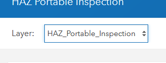

@ChrisJRoss13My bad. I read the field name as AboiteauActivityTracking, but that is the layer.
In the top left of that same page on Portal, are you in the correct layer (i.e., AboiteauActivityTracking)?
I am wondering if there are duplicate fields named AboiteauID.
Given that this issue is related to republishing, if this doesn't resolve the issue, you may wish to create a new thread as it will be easier to help there. Be sure to include your XLSX if you do make a new thread.
ChrisJRoss13
@abureauxI've confirmed I'm working within the correct layer. The problem arises with the use of the autocomplete search() function on a hosted feature layer. When incorporating a select_one option in the choices tab of the survey, it's necessary to define the list name. Additionally, in both the name and label columns, the queried field name must be specified. For our situation, that field name is 'AboiteauID'. Essentially, 'AboiteauID' acts as a temporary marker. As the search() function executes, it generates a list of actual 'AboiteauID' values, each no longer than 9 characters. However, Survey123 Connect interprets the field name 'AboiteauID' itself as a selectable option within the list, leading to a discrepancy as it exceeds the 9-character limit by being 10 characters long. This discrepancy triggers an error. I'm seeking a solution to utilize 'AboiteauID' values in the choice list without encountering this error.
abureaux
Right. I see what you are saying now (I was able to recreate this issue). Seems like a bug. And the bug appears upon every publish attempt. This would need to be logged with Esri support and a deficiency created. I'd recommend calling support to get this process started.
Publish #1:
Publish #2:
But this doesn't help you right NOW... So, I will ask: Do you really need to specify a field length on a select_one? Seems redundant. Removal of that limitation should resolve your issue I'd think. And being a select_one, the user can only select what you specify anyways.
ChrisJRoss13
@abureaux Appreciate you looking into this deeper. I will likely log with Esri support. I am not specifying a field length on the select_one. The field length definition comes from the original hosted feature layer which is used in other applications including map viewer, field maps. I had the field length set to 9 to ensure that they values that get entered via map viewer/field maps are not longer than this value. This was done before I planned to use Survey123 as well. I will likely have another scenario where this error will occur. If I am carrying out the same search() function on a field that has a domain. The field name will be longer and the values will be restricted to that are which defined by the domain. May have to see what comes back from support.
