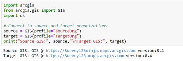

To start, we are going to need two GIS connections; one to our “source” organization, which is the organization in which the survey and content currently resides that we would like to clone; and another to a “target” organization, which is the organization that we would like to clone the survey and content to.

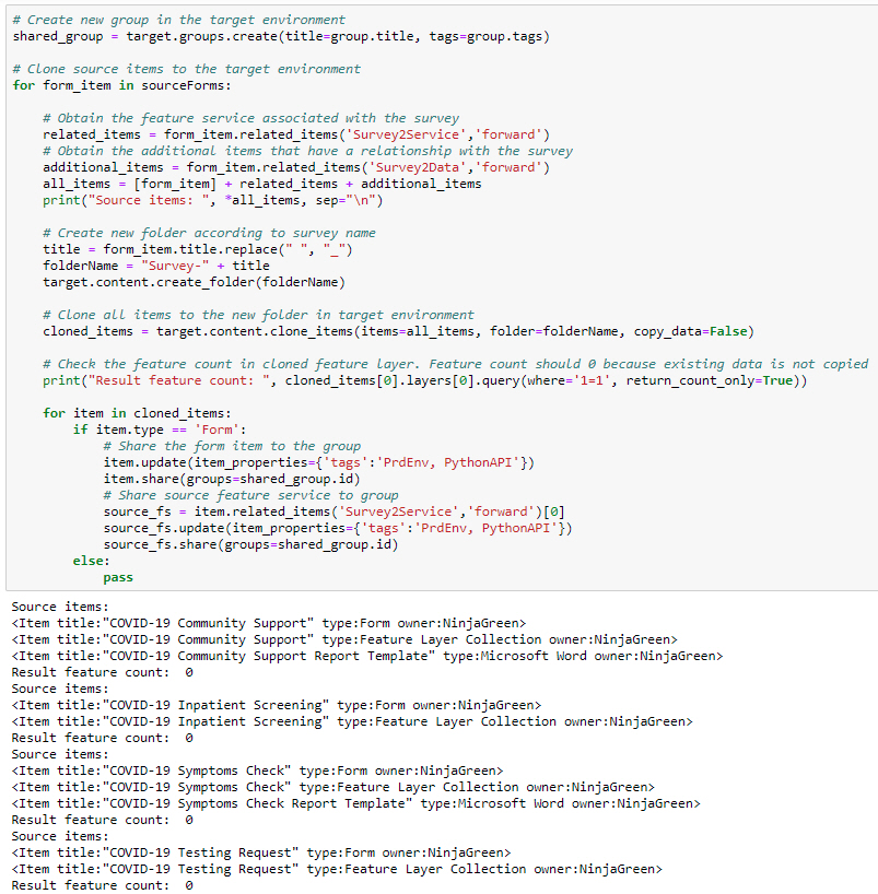

The code below starts by creating a new group in the target organization using the same title and tags as the existing group in the source organization. Once the surveys are cloned, they will be shared to this newly created group.
Each form item in the source group is looped through, obtaining the feature service associated with the survey through the “Survey2Service” relationship, as well as any additional items related to the survey using the “Survey2Data” relationship. This would include any linked content or report templates associated with the survey. All related items are merged into a list to be cloned. Please review the relationship types documentation for more information on related items in ArcGIS.
Next, a new folder in the target organization is created based on the survey name, and the items in the list are cloned. Since the `copy_data` parameter is set to “False” in the clone_items() method, the resulting services created in the target organization will not contain any data. This is ideal when cloning from a development environment to a staging or production environment, as you might not wish to retain any test data.
Finally, the form items are shared to the group in the target organization that was defined previously, including the feature service, and tags are added to each item.

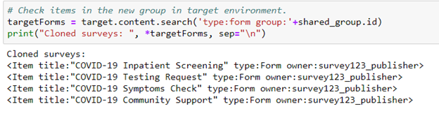

As a confidence check, let’s query the newly created group and confirm our four surveys have been shared.

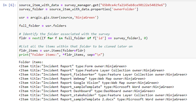

Clone full survey folder:
The code below demonstrates connecting to one specific survey within our organization. Using the properties of the survey, the folder ID where the survey resides is assigned to a variable. Next, all the folders in the source organization for the source username are listed. Using list comprehension, the folder in the `full_folder` variable is matched with the folder ID obtained from the survey properties.
Once the correct folder has been identified the contents of the folder are listed.

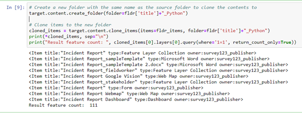

Now that all items to be cloned are in a list, a new folder is created in the target organization to store the content. After the folder is created the content is cloned to the target environment. Since the `copy_data` parameter is not defined the default value for the parameter is “True”, meaning all the underlying data will also be cloned. This means the resulting content in the target organization will be an identical clone of the original data. If you do not wish to retain the source data, setting the `copy_data` parameter to “False” will only clone the data schema and architecture to the target organization. Meaning the survey, web maps, web apps, dashboards etc. will configured as per their original items; the only difference is the feature layer will be empty.
