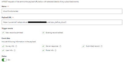

Open survey123 website, and got into the survey's Settings > Webhooks.
Add a new webhook and use the trigger URL as the payload URL:

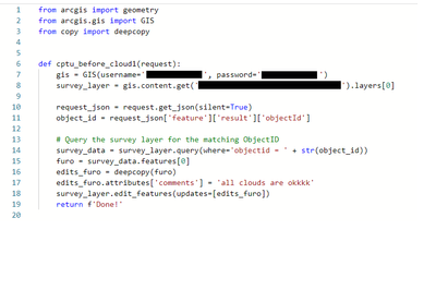

Sorry for reviving this thread, i have been trying for the last 2 days to implement a direct link from a webhook to my cloud function. I followed all the steps above but it seems that something is missing. this is my simple code:

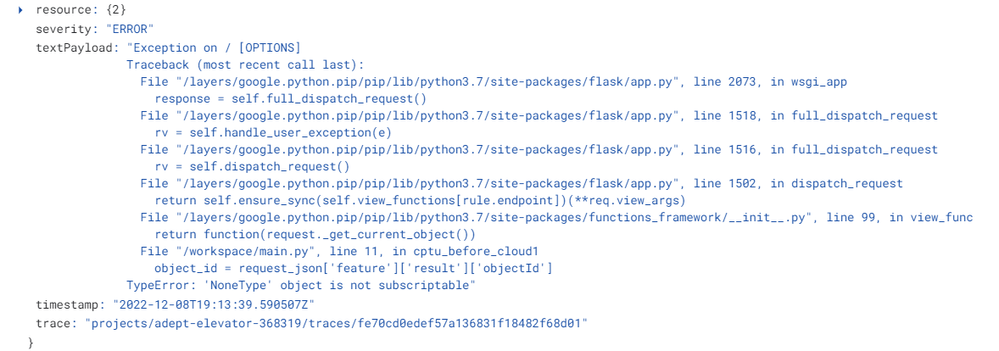

As seen above, i just try to extract objectid from the incoming json.  My function allows for unathenticated invocations, so i hope my issue shouldn´t be token related. Here is the error on gcloud logs:
 When using Make to capture the payload, everything works perfectly, json payload is collected in the expected shape. But in the cloud function, it keeps returning that error. Any thoughts??
GilMastrapa
Last friday found out the problem: CORS.
As stated here, https://community.esri.com/t5/arcgis-survey123-questions/calling-a-custom-webhook/td-p/1025136 , it seems that "The webhooks do not originate from the server, but from the client". When i tried from the android app, it worked flawlesssly.
