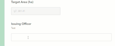

Interesting. I've found this because it seems the WebApp is still not honouring the WhenEmpty option. I've published a survey from Survey123 Connect (3.25.27) to ArcGIS Online, and when using the survey with existing records via the Experience Builder widget, empty values are not recalculating (unless I expose the field and make editable so the user can click the recalculate button). Bottom line in the below screenshot (issuing_officer).
Example feature selected with empty value:
Recalculate option doesn't even show up unless I start typing in the box:

Also just tested in the standalone webapp editing a feature with an empty field. Same outcome.

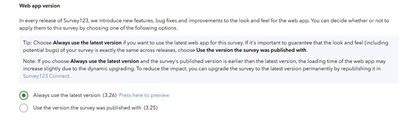

@RoshanPalikhe1 After some trial and error, found a workaround - in the Survey123 Form Browser "Settings" -> "Distribution" tab change to "Always use the latest version" and then republish from Survey123 Connect (using latest 3.25.27 version). (republishing may not be needed but recommended as per description). This seems to fix calculationMode=always and the repeats for our forms... Seems like "Use the version the survey was published with" breaks our surveys after latest July update.

@SerjStol Awesome! Thanks for your tip! I can confirm you don't need to republish the survey (well, at least I didn't need to). Updated the setting on the Survey123 > Settings > Distribution page to use the latest version and refreshed my form in the browser and it started recalculating the specified values.
