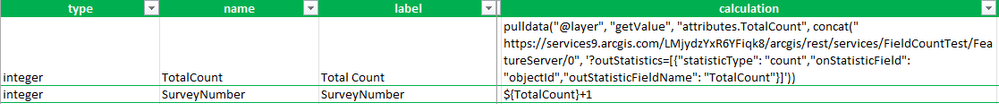

Sounds good so far. With this though, you’re just going to get the number of surveys submitted up to this point. For the prepopulated answer, you need to add one. Just create a new row in the .xls form, and put ${*Name of your total count field*}+1.
AutoID.pngThe layout for this workflow in an .xls form

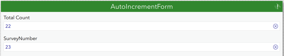

How it looks in the form - the feature class has 22 records, and the second question is the "+1"
It’s probably best to hide the first field and set the second one to read only (which will get rid of the blue Xes). Your use case may vary, but usually the simplest option here is going to be best.
The cachebusting query in an .xls form
We now have a non-duplicative query. Including the timestamp prevents the caching mechanism from serving the same results for the formerly identical query. This tiny crumb of variability, which makes each pulldata(@layer) unique, is perfect for ensuring that our query fetches fresh, non-duplicative information from the dataset.
