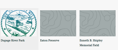

Hi there! I am trying to update an old ArcGIS Storymap using the Map Tour feature (more specifically Explorer Grid). I am creating a tour using the feature service layer that exists in our AGOL organization, however I am not able to edit the location/title/description or add photos. If I start a tour from scratch, I am able to do these features (see images for context). Does anyone know how I can fix this? Thanks in advance!

EthanMcGhee10
Hi Owen,
Thanks for your response. I was able to add a title and description to my points, but I am still having difficulty with uploading images. In my attribute table, I have a field with a link to the photos I would like to use for each tour point (see attached image), but when I update the storymap the tour still shows null photos. Is this a problem in the way I have linked the photo in the attribute table, or am I missing something else?

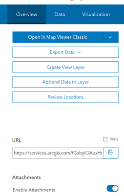

Navigate to your feature service in AGOL --> Overview --> Enable attachments
Then open your feature service in a webmap --> click a feature in the map --> Add Attachment
Or open the attribute table and add the attachment that way

AdriannaBuxrude
Hello!
I am trying to create a data-driven map tour, but I need help. I logged into AGOL, went to the overview tab for my feature layer, and scrolled down to find the attachments section, but I didn't see one. I don't have the option to enable attachments. I attached a screenshot of what I see.
OwenGeo
Esri Notable Contributor
@AdriannaBuxrude -- Please review the documentation for allowing attachments on features layers here: Manage hosted feature layers—ArcGIS Online Help | Documentation
One thing I can think of is that you haven't yet enabled editing on the feature layer, which is a requirement for enabling attachments.
