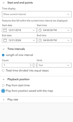

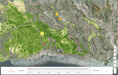

It appears that every time I reopen the web map, regardless of what I set it to before, it resets. I have to click to go back into the time slider to get it to restart.
Attached are photos of the time slider initially when I open the webmap, and the settings when I open them.
