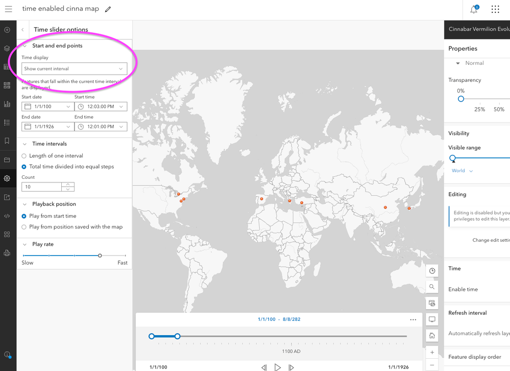

Hi @SaraJL , Sorry for the late response here! I was able to reproduce the same issue with the data you provided. When I changed the time display setting in the Map Viewer to "Show current interval", I was able to save the map to the story successfully.
Let me know if that works for you, and I'll try in the meantime to reproduce this with other data to see if this isn't a wider spread issue across time-enabled data!
