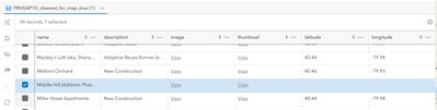

@JoshuaBSmall -- Turns out there is a feature that does not have a valid geometry defined and that is what is causing the error. As far as we can tell, this is very rare and the current feature service creation workflows don't allow this.
If you delete this row, I believe your tour should start working or at least you should be able to create a new tour from the modified feature layer.
