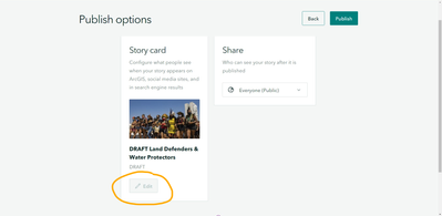

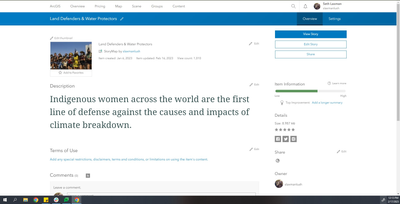

I published a storymap, and the interface will no longer let me edit the title and description in the storycard. When I go to the project in arcgisonline, I can change the title and description and save the changes, but when I view the storymap, it doesn't update.
SethLaxmanLush_0-1676654055911.pngHere you can see that I have successfully updated the title and description.
SethLaxmanLush_2-1676654187027.pngHere you can see how the previous version persists despite the changes I made and saved.

@SethLaxmanLush It appears you are using a free public account, which has some limitations, so the ability to customize the social metadata used when you share a story online is not available.
If you want to edit your story title/subtitle, you'll need to do it on the cover in the story builder. That information will overwrite what's in your item information in ArcGIS each time you publish.
