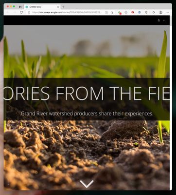

After a quick look, the only out of the ordinary thing that I see is that you haven't specified a title for your story and have burned text into your cover image. While that shouldn't crash the page, it's not recommended for several reasons.
It's not good for anyone reading your story on smaller screened devices or narrower browser windows since the text in your image will get cropped, as shown below. When you add a true title the text is resized so that it always visible. Be sure to use the Preview feature in the story builder to look at what your story will look like on other devices before publishing it.

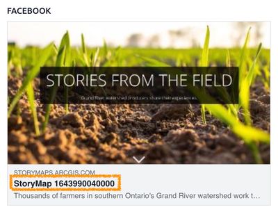

Also note that if you don't have a title, your story will have a cryptic numeric title when it's shared on social media sites or when it comes up in web search results... You can use the new Share card feature to address this. For more information about that feature, see What’s new in ArcGIS StoryMaps (February 2022) (esri.com).
